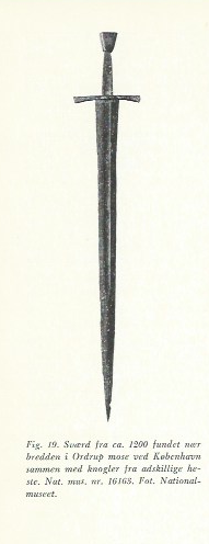

XVI.3 From the Nationalmuseet, Copenhagen
"Found in Denmark, this sword is in excellent condition. The edge erosion is likely caused by wear and honing rather than corrosion. There is a four-letter inscription found inlaid in the fuller. Like our previous examples, this piece dates from the first half of the 14th century."
This sword is from Ordrup Mose (North of Copenhagen), where it was found near the bog-shore along with numerous horse-bones from many horses!! [and apparently nothing else].
It was originally thought to be from ~1200 AD [Danish 1970 article], but apparently Oakeshott placed it from ~1300-1350 AD
Was someone doing a pagan sacrifice involving horses and sword in the ~1300 AD out at the bog - seriously old school??
The inscription on the blade is a 5-letter combination [not 4-letter] - NNDIG - according the article. No clue as to what it means, but likely a magical abbreviation.
Actually when I look at the close-up picture in the book I see 6 letters in another order along the blade. WTF?!
NI.........N.........D..........I........U? [picture just cuts the last letter, so could be the G I guess]. Well it seems the close-standing NI was somehow missed. Anyways it still doesn't make any sense.
So here is a scan from Nationalmuseets Arbejdsmark 1970. Rikke Behrend. “Vandfundne sværd fra middelalderen", page 100.
Sword inventory: Nationalmuseet nr. 16163.
 Attachment: 96.86 KB
Ordrup Mose Sword.
Source: Behrend (1970). Nationalmuseets Arbejdsmark 1970.

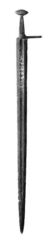

This sword has a twin, found in Geertruidenberg in the Netherlands in 2005. In very poor condition, but has a much longer, elaborate inscription which includes multiple repetitions of DIEU ("god" in French).
http://www.regionaalarchieftilburg.nl/wiki/Het_Zwaard

For the Geertruidenberg sword, I have the following pommel measurements: "4 x 4 cm and 4 x 2 ½ cm". Source is either the link I posted or another article I think I have somewhere...
Oakeshott states there is another XVI identical hilt in Bern, inventory no. 840.6. I don't have any other picture or source on that one, maybe you can find something! Wink
It seems like these three are an unusual group of the type T pommel occurring with XVI blades and at an early date.

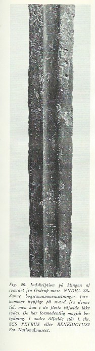

The Danish find was an old non-professional dig, so they used the letters on the sword for a dating to Late Middle Ages according to the Dutch article.
Source: http://www.regionaalarchieftilburg.nl/wiki/Be...chrift.jpg
The dutch sword has an inscription that uses the same kind of letters as the Ordrup Sword [for instance the N's and the "G" that perhaps is a substitute for C according to Wegeli, see below]
Found the Oakeshott info and he does in fact report 6 letters on the Ordrup Mose Sword, but as + NINDIC + [also starting and ending with crosses] and then dates it to 1300-1330 AD based on Wegeli. [The sword at the end of chivalry, page 62].
This must be his source: Inschriften auf mittelalterlichen Schwertklingen von Rudolf Wegeli (1904).
Found it online: http://daten.digitale-sammlungen.de/~db/0006/...mp;seite=1
His reading of the Ordrup Sword is on page 25 & 27 and he reads it as NNDIC [apparently DIC/DIG are very commonly seen].
"Die inschrift + NNDIC + ist in gelber Metallkomposition eingelegt" So that's a new info about the Ordrup Sword.
So he misses the closely set NI as well or just reads it as N for some learned reason??
I am inclined to read it as NnDIC... it is common to see the same letter written in different ways within the same inscription, particularly "N" vs. "n" and "E" vs. "ϵ".

I'll scan the picture tomorrow from Behrend (1970), so you can maybe see
Please do! I can already see all the features you mention though... ultimately it is subjective, to me it just seems closer to a form of "N".

So I'll throw out a wild hypothesis:
Im thinking that the possible NI could be a ligature! Used for an abbreviation/title.
Maybe the possible ligature "NI" is for "numerati" (Latin, numbered) then N and then followed by the DIC/DIG.
Less esoteric: Serienumber/Type N "DIC", maybe the sword maker (DIC).
More esoteric:
Maybe the number/rank of the wielder -> if he is within some kind of order, so by secret code he can identify himself to other members via his sword.
So what could DIC be: [Going wild here - don't even believe it myself, but fun if there is any kind of precedent that could make it possible].
DIC could be for "dicitur" ("said"), while perhaps DIG could be "digitur" ("Finger" - actually also toe).
Are those with DIC "readers of the bible" and those with DIG "finger-men" (warrior-monk, soldier?).
Member(rank): "N" dicitur/digitur. [N could be "Nobilis"].
Off course the sword could just start with NN instead, and so many abbreviations are possible. Doesn't even have to be in latin.
 Attachment: 215.53 KB
Letters on the Ordrup Mose Sword (picture not including the crosses before and after).

Thanks for the photo. Happy
There is a precedent! There are several swords with inscriptions based on the latin psalm:
"Benedictus Dominus Deus meus, qui docet manus meas ad prælium, et digitos meos ad bellum"
("Praise be to the Lord my Rock, who trains my hands for war, my fingers for battle" in modern versions)
The first portion of the psalm appears on the pommel of the Reichsschwert/Sword of St. Maurice in Vienna in the following way:
BENEDICTVS · DOS · DES · QVI · DOCET · MANV
A more complete text appears on a sword from Paczkow in Poland, including the word "digitos":
A sword from Seewen in Switzerland includes "meus ad prelius" but not "digitos".
Alternatively, maybe DIG should be read as DIC, possibly as an abbreviation of "benedictus"?
I still think this is what we have here, based on comparison with other inscriptions that seem to unambiguously start with "Nn". Figure 38 in Wegeli for example, or the Cawood sword:
Potential meanings are endless of course... but maybe "N[omine] N[ostre]" as a contraction of "in nomine domini nostri Jesu Christi"?

Mark - you have an astounding knowledge on latin sword inscriptions!
I think that you are probably right that NN as N[omine] N[ostre]" (contraction of "in nomine domini nostri Jesu Christi") is probably the most likely explanation.
I'm amazed that the "DIG" hypothesis I just presented while brainstorming actually have a precedent!
The line - Benedictus Dominus Deus meus, qui docet manus meas ad prælium, et digitos meos ad bellum - is from Psalm 144 (verse 1) in The Old Testament, where David sings a praise to God, who gives victory to Kings (verse 9-10) -> it's certainly martial.

Behrend gives infact NNDIG whereas Wegeli gives NNDIC [off course Behrend's pictures cuts of the last letter Mad].
If it's NNDIG is could be a splendid joke: NNDIG -> In the name of our Lord I give you my finger (of war). Laughing Out Loud
That would be very Danish.
The Roman index finger seems to have been used by early Germanic people as well presenting it to Roman Armies....
As for DIC being "benedictus" (blessed) its possible. [But then it should appear early on in the sentence]
I just find it interesting that so many of the swords (what I saw in Wegeli) seems to have a DIC/DIG variation later on in the text, so it's maybe more like as DIG could be digitur, then DIC should be something starting with “Dic...."?
I'm amazed that the "DIG" hypothesis I just threw out that actually have a precedent!
Is there any length variation of the swords with abbreviations of "Benedictus Dominus Deus meus, qui docet manus meas ad prælium, et digitos meos ad bellum" connected with age of the sword??
One could speculate that the oldest swords would have more full inscriptions and as the line gets more and more commonly used, then shorter and shorter abbreviations would be adequate to convey the message [I'm assuming that having inscriptions on the blade is not only for oneself, but also a message to other people seeing it - either they got the meaning or they don't (hence esoteric)].
[Off course it could also be just simply finances, as longer inscriptions would cost more, and perhaps potentially also weaken the sword?].
Furthermore having a special phrase on your sword could easily also be a way of stating a certain group-membership.
The martial-godly mix of the line fits, what a warrior monk would chose [Hospitaller or Templar].
With this sword in Denmark certainly makes Hospitaller much more likely as they were very powerful here.
The Danish Hospitallers had their seat on Zealand; Antvorskov, near Slagelse. [Called Johanitter-Ordenen in Danish]
Source: http://en.wikipedia.org/wiki/Antvorskov
I'm just interesting that so many of the swords (what I saw in Wegeli) seems to have a DIC/DIG variation, so it's maybe more like as DIG could be digitur, then DIC should be something starting with “Dic...."?
Alternatively, NNDIC could stand for Nomine Nostri Dominus Iesu Cristos (In the Name of our Lord, Jesus Christ) -- you have to remember that Latin only had 24 letters, missing J and U, which were written with I and V respectively. (Julius actually appears in Latin inscriptions as Ivlivs). Thus the "I" in NNDIC could actually represent a"J".
A very elegant and simple solution.
As for use of Ockham's razor, that would be best guess for the "NNDIC".
Only a bit worried, why change the established word order ?
"NDNIC" would be the normal for "(In) Nomine Domini Nostri Iesu Christi".
So the first N could in fact be a ligature for the "in nomine".
Because of the case system though, you can change word order without change of meaning [not qualified in latin to know if this in fact works in this case]:
So "in Nomine Nostri Domini Iesu Christi" as a possible NNDIC variant of the common NDNIC.

They refer to Wegeli - through Bruhn Hoffmeyer - that DIC stands for "Dominus Iesus Christus".
The NNDIC could then possibly be seen as the answer to a question: Nomine Nostri? Dominus Iesus Christus [here the full title in nominative, masculinum, singularis].
As Kings often used "royal plural" it could have this meaning: Our name? Lord Jesus Christ !
It still a bit weird though, but it also bugs me that the full sentence "in nomine nostri domini Iesu Christi" has reversed the more normal "..... domini nostri......".
As for the DIC/DIG: Are the DIG-examples really with a “G“ or just two variant ways of writing "C"'s as you have two different N's as well, and Mark you also show-cased the example above with different U's. Then again Wegeli and Oakeshott reports a DIE variant, so DIG for possibly "finger(s)" is totally feasible.
Funny that we use NN today for Latin "Nomen Nescio" ["I don't know the name"] and it ancient Rome the hypothetical defendant in Roman law cases was known as "Numerius Negidius" [one, who denies payment] while the plaintiff was "Aulus Agerius" [Aulus (name), that puts in motion]. Neither of these seems even remotely likely here Laughing Out Loud

A possibly Danish solution to the letters [though I stress it as less likely than a Latin]
If you somewhat follow Nordic naming tradition with personal name - patronymic and nickname [though nickname is in Iceland most often between First name and patronymic] then vi have N (possibly ligature Ni) N DIG.
Nikles (medieval version for modern Niels and a very common name back then) Niklessøn (likely a family naming tradition) Dighær [cognate with Old Norse adjective Digr = Stout - so big, fat and strong].
So Old Danish: Nikles Niklessøn dighær.
Modern Danish: Niels Nielsen digre.
Translation: Niels son-of-Niels "the Stout".
[You had a Jomsviking called Búi digri in the Icelandic sources. Old Norse Búi is in Danish "Bue" or "Bo" meaning “dweller“ and an Orkney-Jarl Sigurðr digri].
What do we find on the Sword - a stout pommel fitting for a stout man ! Laughing Out Loud
St. Nikolaus was extremely popular in Denmark and according to Saxo Grammaticus King Erik Ejegod got his saintly bones as a gift (as well as part of the true cross) by the Emperor Alexios I Komnenos in Constantinople while on the route to Jerusalem on pilgrimage. He died on Cyprus in 1103, but the relics were send back to Denmark. Erik Ejegod was followed by his brother as King - his name was Niels/Nikles.
That could be a simple ownership identifier on the sword written in Old Danish with latin letters.

A Danish sword from Enslev, near Randers, Jutland has no starting NED , but just + EMEDE + as is seen on the St. Omer sword. Three other swords starts with NED, but don't have the EMEDE.
Enslev Sword:
It's 95 cm total length, whereas the hilt is 10 cm.
Blade is 4,5 cm wide.
Only half of the cross-guard is preserved.
Iron Pommel.
Wide fuller.
No close up, so we have to trust the information from the National Museum and Wegeli.
 Attachment: 12.51 KB
Enslev sword with + EMEDE + inscription.
Source: http://samlinger.natmus.dk/DMR/168110
