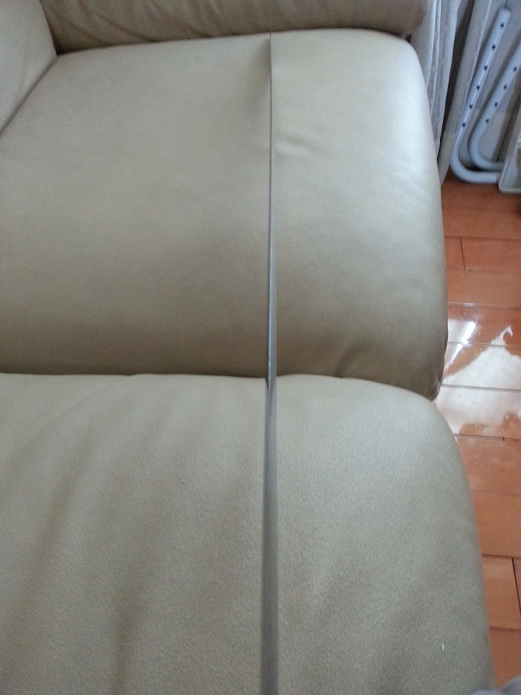

Craig Peters
PostPosted: Fri 08 May, 2015 7:50 pm    Post subject:         Reply with quote
Let me clarify about my sword. About 12 inches or so from the point, the sword subtly begins to curve to the left. It's not so dramatic as to be immediately obvious when looking at the sword. But if you look straight down the edge of the blade, you can see the slight curvature.
Looking at my original post, I see that using the word "bent" was maybe not the best choice, because it could imply more dramatic damage. Sorry if I caused confusion.
Edit: Here's a photo of the sword. This is after I had pushed against the flat in an attempt to straighten it.

PostPosted: Sat 09 May, 2015 1:23 am    Post subject:         Reply with quote
No worries Gregory, I'm just trying to understand the issue just as you are.
Craig thx for the pict. I suppose you could clamp the sword in a vice between two slice of soft material (wood, rubber jaws etc) and bent it the other way. But as said, there *might* be a risk of snapping the sword. I've seen swords straighten this way, but right after heat treatment. I would be very uncomfortable attempting this without some guidance from an experienced smith. For me a PM to Peter J would be the way to go Happy

Glen A Cleeton
Location: Nipmuc USA
Posts: 1,968
PostPosted: Sat 09 May, 2015 10:35 am    Post subject:         Reply with quote
Guys,
Marquenched 6150, as displayed by the Albion sword is going to resist straightening much more so than a deferentially heat treated katana or non heat treated piece of stock as shown in the videos and the diagram shown on th SBG site.
What I am going to suggest is not for the weak at heart (or simply send it to a smith or Albion). Warm/heat the blade at the curve. Not to an extreme heat but much hotter than you would want to hold (not even a straw or blue heat). lay the sword on the floor. Step on the curve and lift up the hilt. Don't be extreme in this but you will have to go a lot further in the other direction to bring it back the other way. Repeat as necessary. A small amount of heat will help it relax without disturbing the temper. A large vice will certainly work but let's go caveman and think about the possibilities if one does not have tools.. Two posts of rail, any way to create a fulcrum to bend across. In my example, your foot the fulcrum.
As thin as your Albion is at that point (heh), you will probably succeed but it may tend to curve again. It is quite possible it was curved when you received it. These things happen, even after the quench and tempering stages. Gus had a blade returned (5160 similar heat treat similar steel) and even after fixing it, it just wanted to curve again when let alone for awhile.
Bends at the hilt are difficult to deal with unless stripped from components.

PostPosted: Sun 10 May, 2015 9:13 am    Post subject:         Reply with quote
Yeah, sometimes heat treating creates internal stresses in the blade that make it "want to" curve one way or another when subjected to external stress. Sometimes they're created in forging, sometimes they can even be inherent in the stock, already. The quality of the maker or their work has surprisingly little to do with it, too - no matter how good they are, every smith I've ever known gets nervous when it comes time to quench because it can be such a crapshoot even when you do everything right - and if the blade doesn't warp immediately during the hardening and tempering process, these inclinations can be downright impossible to notice.
