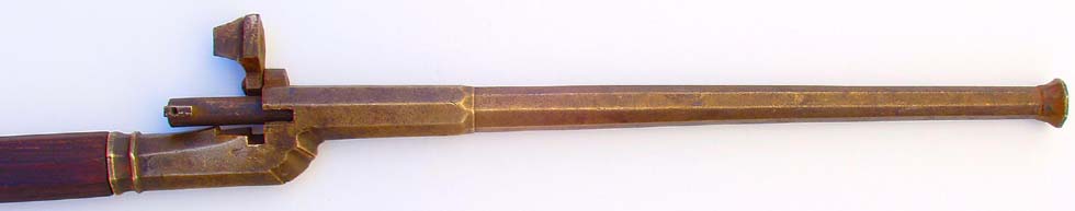

and this is another from the same Baltic region, a hook gun which can be on the borderline between artillery and handgun
http://s600.photobucket.com/user/rocklockI/me...k.jpg.html
Here is an original cast bronze gunbarrel from Nuremberg, made some time before 1399
some early forged iron gunbarrels, I think from Nuremberg
Plan of the interior
There is a detailed article about these particular handguns here, which explains how they performed much better with the earlier types of powder:
http://www.musketeer.ch/blackpowder/handgonne.html

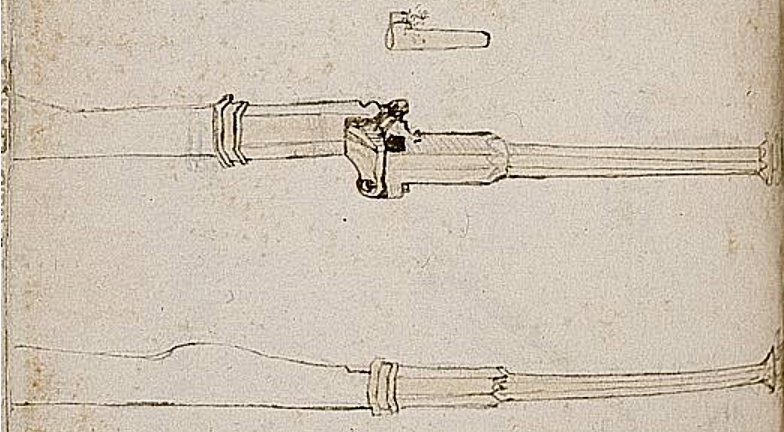

By the second quarter of the 15th Century, firearms tech leaps ahead, and you have some amazing examples of technology, again I believe at least partly inspired from the shooting contests. One amazing example is this breech loading firearm from Nuremberg, I believe mid 15th Century
http://www.vikingsword.com/vb/attachment.php?...&stc=1
There are plans for a very similar weapon which were made by an Italian artist and gunsmith named Lorenzo Ghiberti (who died in 1455)
