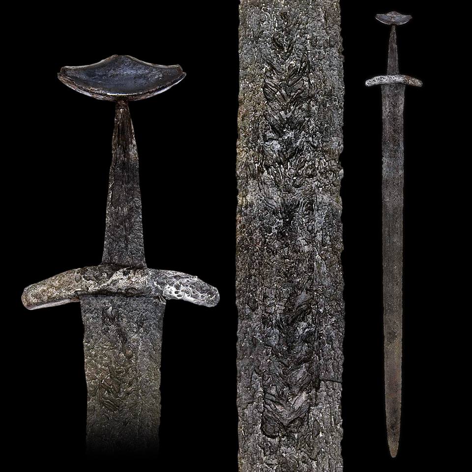

Luka Borscak
Location: Croatia
Joined: 11 Jun 2007
Posts: 2,307
PostPosted: Thu 19 Mar, 2015 2:39 pm    Post subject:         Reply with quote
In my opinion, the artist wanted to picture a type Y sword. It is the right period for them and the looks are right, he maybe just missed a bit of the concavity of the pommel... They even have the line separating "upper guard" and pommel. Maybe some of them are even two piece.

J.D. Crawford
Location: Toronto
Joined: 25 Dec 2006
Posts: 1,911
PostPosted: Fri 20 Mar, 2015 9:06 am    Post subject:         Reply with quote
I was thinking something similar Luka; Oakeshott called it an N, which would have been a century out of date, but a Y could have been drawn from life. Would be nice to see the original to see how ambiguous it was or was not.
By the way, have you seen the Michael Pikula version of your first pictured sword, owned by Tim Lison? That's a classic.
