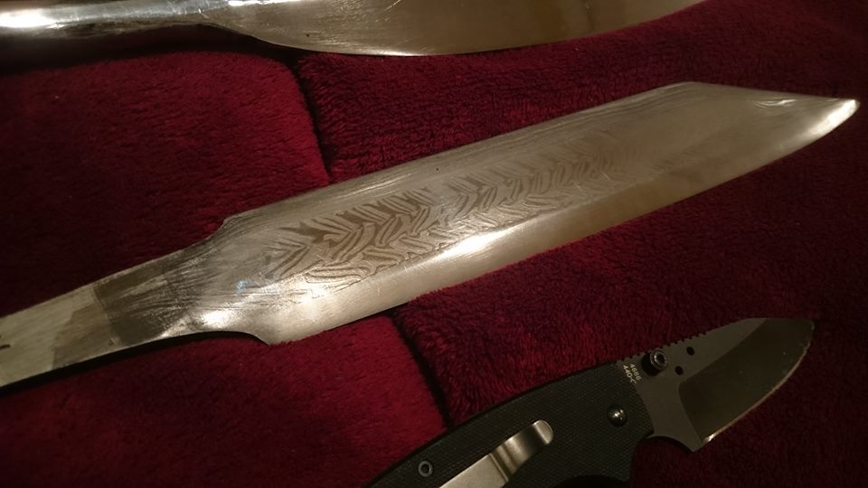

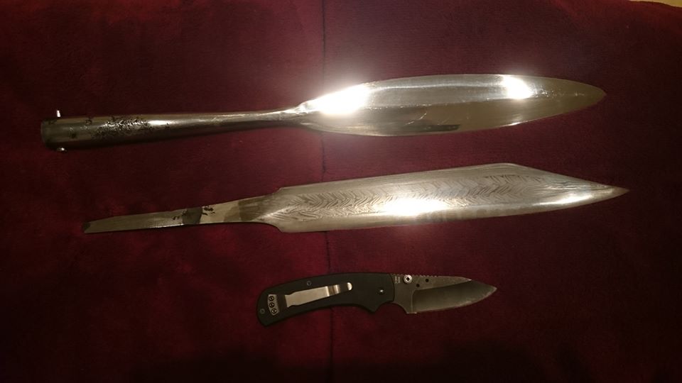

I recently picked up a pattern welded seax blade from Paul Binns and am intending to hilt it myself (or perhaps have a friend do it for me). I've been searching through threads on this forum and elsewhere, but am really surprised by how little I'm managing to turn up by way of historical examples of seax hilts - either archaeological or in art. What are the most fancy seax hilts we know about, either surviving or in art? (specifically largish seas, rather than the small eating type)

So few survive as anything other than just legacy marks on the tang that we don't really have a big enough corpus of material to make an absolute judgement on either shape or decoration.
Unfortunately, those which do survive are (with the exception of the Swedish Vendel period ones) overwhelmingly plain.
There are some nice examples of carved, decorated smaller knife handles, but not for seaxes in either art or archaeology.
You've taken a trawl through Jeroen's library of seax pics?

Seaxes were popular for around 500 years, and have been found from Italy to Norway, so there are a wide variety of types and styles. Your blade is of the brokeback type (type IV in wheeler's classification), and unfortunately there is only one I know of that has the handle intact, the Aachen seax, aka. the hunting knife of Charlemagne:
Going by memory, the handle is bovine horn, the end-cap/wrap is either bronze or silver, and the handle is around 8 1/2 inches in length.
In addition to this, we have some period illustrations:
Earlier styles of continental saxes (langsax, breitsax) had long handles. The only exception to this are the Nordic saxes, which had handles in the 4" to 5" range. The are many type IV seax sheaths remaining even when the knife is long gone, and they also indicate long, straight handles. As far as I know not a single type IV seax blade has been found with a cross-guard or pommel, nor do they have them in period illustrations. Based on the scant evidence, I think a long, simple one-piece wooden or horn handle is our best bet for a historically correct handle for this type of blade, possibly with ferrules.

Fantastic, many thanks. I hadn't seen most of Jeroen's examples before, only really the UK ones. I have actually excavated seax myself, as an ex-archaeologist (in Normandy on a Merovingian site which had loads of weapons). However i have never seen one with any hilt elements remaining personally. From a functional point of view I find the smooth straight grip a little problematic, as it doesn't seem to offer a very secure grip. Though I suppose with a long enough hilt, as most of these seem to have had, perhaps it doesn't matter - if the hand slips a bit then it has space to slip… like the shaft of a spear or axe. I suppose it might be reasonable with an Anglo-Saxon seax grip to go for something simple like circles and dots decoration or incised lines?
