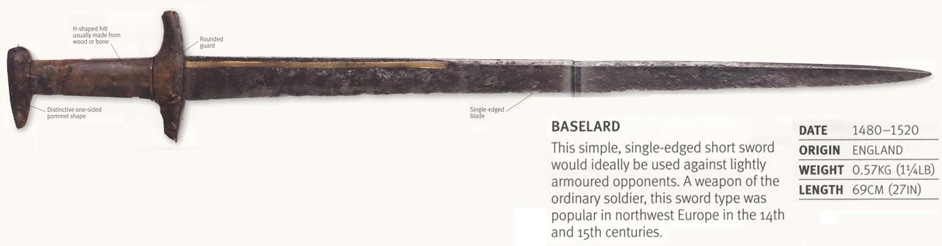

7) Baselard
Museum: ?, UK?
Picture attached
Museum Number: ?
Period: 1480 - 1520
Origin: English
Blade: Single Edged
Overall Length: 69 cm
Blade Length: ?
Blade Width: ?
Hilt Width: ?
Weight: 570 grams
Information Source: Book- Weapon A Visual History of Arms And Armour published by Dorling Kindersley
Picture published in: "Weapon A Visual History of Arms And Armour published by Dorling Kindersley"
Replica: ?
The information above maybe suspect as Dorling Kindersley is not the most reliable of sources.
I think this Baselard has to be from a UK museum (Royal Armouries / Wallace Collection / British Museum??)

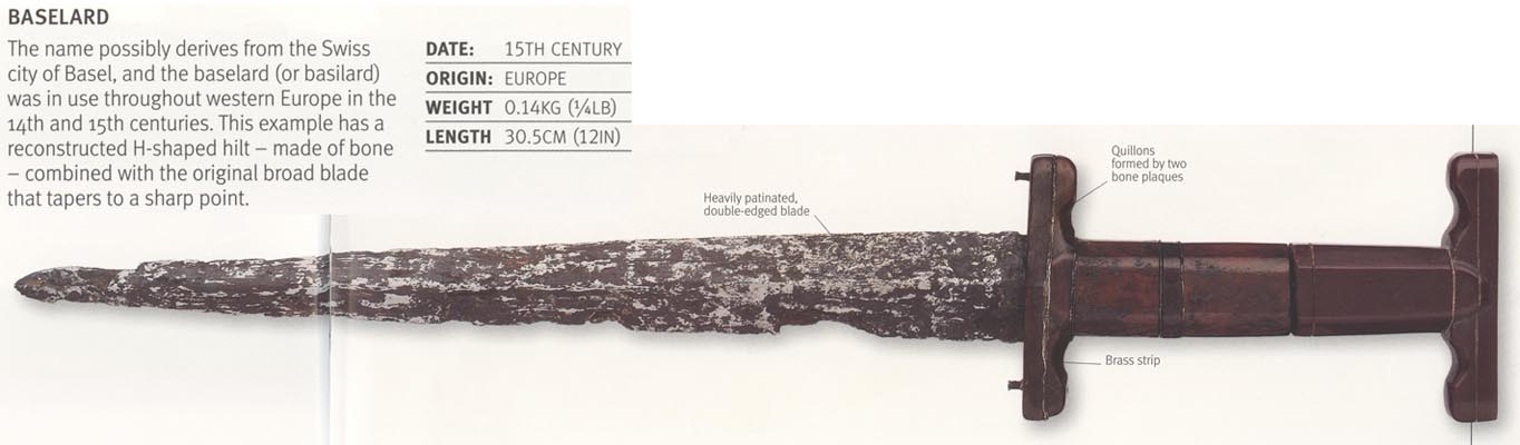

8) Baselard
Museum: ?, UK?
Picture attached
Museum Number: ?
Period: 15th century
Origin: ?
Blade: Double Edged
Overall Length: 30.5 cm
Blade Length: ?
Blade Width: ?
Hilt Width: ?
Weight: 140 grams
Replica: ?

PostPosted: Fri 22 May, 2009 4:57 am    Post subject:         Reply with quote
One of the ones you attached looks less like a baselard and more like the English backswords some people call the "Wakefield" style.
I mean swords like this (from this thread):
The middle one:
The sword on the left is more baselardy to me than the middle one.
The broken guard of the one below, which the bookyou got it from called a baselard, is more like the so-called "Wakefield" swords above and the asymmetrical pommel seems to be more like them, too.
Chad
There's a 2nd Basleard (IX.3482) in the Royal Armouries at the link below. No pic I'm afraid. The description is the same as in the pic I posted.
http://collections.royalarmouries.org/index.p...7&pg=1
So perhaps part of the hilt has snapped off to make it look un-Baselard like?
Can anyone confirm if this is the same weapon or not?
Has it been published in any other books apart from the Dorling Kindersley one?
7) Baselard
Museum: ?, UK?
Museum Number: ?
Period: 1480 - 1520
Origin: English
Blade: Single Edged
Blade Length: ?
Blade Width: ?
Hilt Width: ?
Weight: 570 grams
Replica: ?
Regarding the Wallace Collection A503 Baselard, the Royal Armouries X.297 one and the one from the Metropolitan Museum.
Does anyone have any further information about them? Full dimensions / specs etc?

PostPosted: Thu 28 May, 2009 7:30 am    Post subject:         Reply with quote
I think using the DK books as a reference is not always the best idea. Some of the captions and descriptions they use for photos are just plain incorrect, unfortunately.
