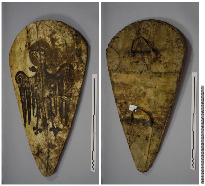

Yeah. I did a ton of research for a project a while ago and came to the conclusion that wooden shields aren't really wooden exactly, they're more like laminated composites.
I found a pic of another kite that's thought to be original and I've got a pic of this same shield in a collection. Personally I think it's plausible that it's original. The enarmes are unusual but it appears to have provisions for enarmes higher up and in positions that match what I've seen in period artwork.

That's a really great find. Where is it located? I really like the fact that it has a rendition of the imperial eagle. My guess is that it is one of the rarer examples of a kite shield from the 14th century. It looks a little short for a classic 11th or 12th century kite shield, and the fact that it does not have a boss further corroborates this idea. I have seen examples of shorter kite shaped shields like this one from 14th century art, so assuming that it is antique, a 14th c dating seems probable.
