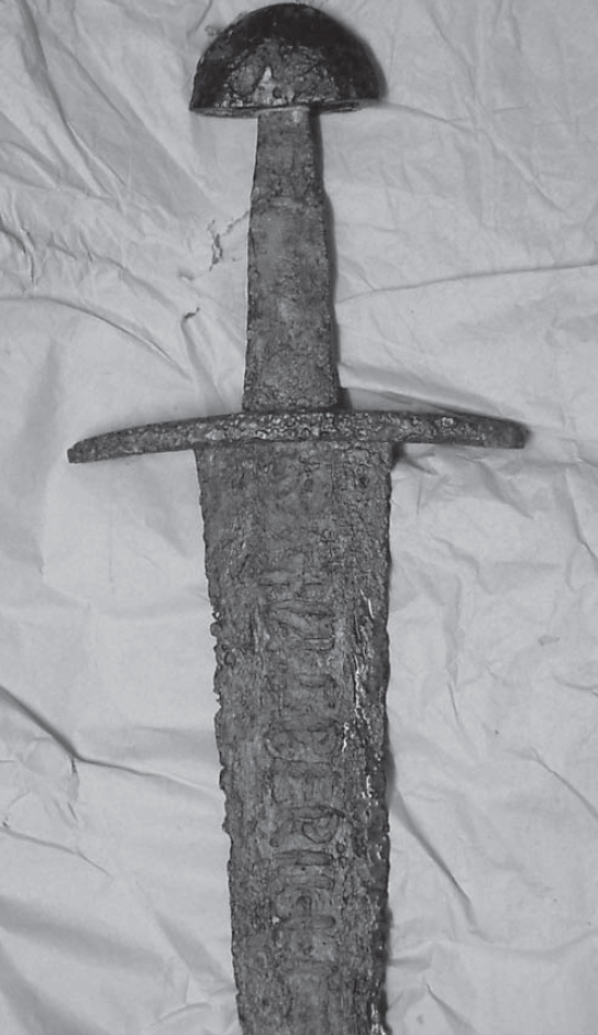

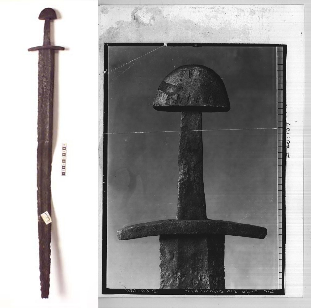

Agree with the others, though the curved cross is something that I think may be more common among earlier Petersen type X's...
Apart from the fuller width, the proportions of your sword match very closely with those of X.5 in "Records of the Medieval Sword", which is a 10th century Ulfberht sword.
 Attachment: 31.1 KB
example in Berlin
 Attachment: 119.02 KB
example in Stockholm [ Download ]
 Attachment: 219.36 KB
private collection, from Danube [ Download ]

Jasper B.

PostPosted: Sun 14 Dec, 2014 11:11 am    Post subject:         Reply with quote
Thanks for all the answers! They are hugely helpful.
Is image you link as X.5 the one you refer to in the above sentence? I looks suspiciously like the sword sold at Bonhams (full image). Are those actually the same (is Oakeshott's reference sword X.5 the one sold in auction at Bonhams)?
Also, is the pommel I've drawn Geibig's type 14, 15 or 18? And what type is the blade in Geibig's typology?
Yes, they are the same. That auction included quite a few swords from the collection of E.A. Christensen, several of which appear in "Records" and elsewhere... browse through the auction photos and you may recognize a few more old friends!
