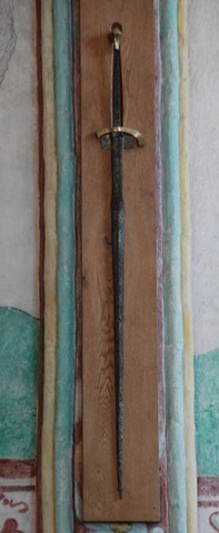

In the Helligtrekongers Kapel (Chapel of the Three Kings) of Danish King Christian 1 (1448-1481) in the Roskilde Cathedral, there is a sword contributed to him and it looks precisely (?) like the weapon the Albion Dane was modeled after!
It was likely used as a knighting sword to the new order “Guds Moders Selskab“ created ~1457 [= Society/Order of the Good Mother - that would later become known as “Elefantordenen“ = The Order of the Elephant]. The chapel was build in 1462 for this ceremony and it was given statutter (by-law?) by Pope Sixtus 4 in 1474.

Jeffrey Faulk
Posted: Thu 04 Sep, 2014 12:54 pm Post subject: |
It is indeed very similar but I understand that there are several broadly similar swords that are extant with the long ricasso and grip. Oakeshott notes a number in his Swords in the Age of Chivalry. It is fairly clearly a style that is very exclusive to Scandinavia, especially Denmark, although there are similar swords from Italy as well. Johnsson's version of the sword is more or less a composite of historical examples, which is largely the case with much of the Albion Next Generation line.

Thanks
So this “Dane“ is an example that is very close looking. Would be interesting to know precisely which swords Johnsson made the Dane from......
There is so few Danish Museum Swords available on the internet, so it is quite frustrating when you know how many we have. It just so hard to take good picture with glass reflection.

Niels Just Rasmussen
Posted: Thu 04 Sep, 2014 1:16 pm Post subject: |
Thanks
There are 4 Scandinavian swords shown on in the last link. The third one looks exactly like the Roskilde one with the broken off crossguard. So they date in 1450-1460 which fits of Christian 1. made the order in 1457 and used the sword for knighting.
Amazingly it's the smallest of the 4.
