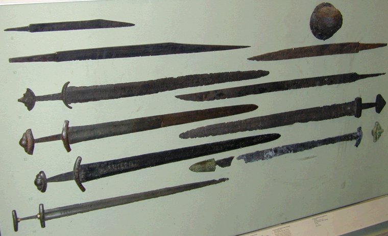

http://www.myArmoury.com/talk/download.php?id=1261
The Little Bealings seax is dated to the 10th century, and is one of my favorites. More information on it can be found here: http://www.myArmoury.com/talk/viewtopic.php?p=178901 and here: [url] http://www.bladesmithsforum.com/index.php?showtopic=18002[/url]
With a 30 inch blade it would definitely qualify as a langsax. It is the latest dated one I've found yet, but I'll keep looking.

PostPosted: Wed 06 Aug, 2014 4:46 am    Post subject:         Reply with quote
Thank you sir!
You have answered my question! I am looking for dates of examples- I realize it is next to impossible to answer the question of how long folks used such weapons given the less than scant pictorial or statuary evidence.
This is a beautiful seax indeed- and at 30 inches, very long- much longer than I would expect.

DO you know anything about the seas just above the Little Beatings in the photo you included? I like the shape on that one and it does appear to still be a longseax.
Sadly, I know nothing about that one.

So here is an image provided by Mr. Ezell. This seax has an 18 inche blade. Does anyone have any more information on it or would guess a date.
I am hoping for an example or solid views on the existence of narrow bladed seaxes (basically anything but broad-seax Honey Lane type) -post 900 (950 even better)- with a blade longer than say 15 inches. So far the only example I have seen is the 30 inch little beatings example.

Jeremy, it appears my estimate of 18 inches long was a bit off, according to this image it is closer to 13-14 inches (if it is indeed the same blade)... However, this image may also be useful in and of itself.
 Attachment: 34.41 KB
