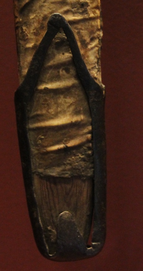

I'll start things off. The first two images are of unattributed chapes from the 12th-13th century cited by Christopher Gravett in Norman Knight AD 950-1204. The third image is from the original scabbard of the "Sword of St, Maurice of Turin" that currently resides in Vienna, and is typically dated to the early 13th century.

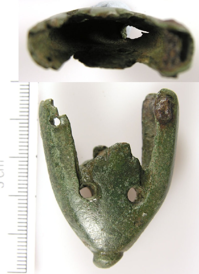

Chape found at King's Lynn in 1997, UKfinds.com. Dated 12th-14th century (and agreeably so). [ Download ]
