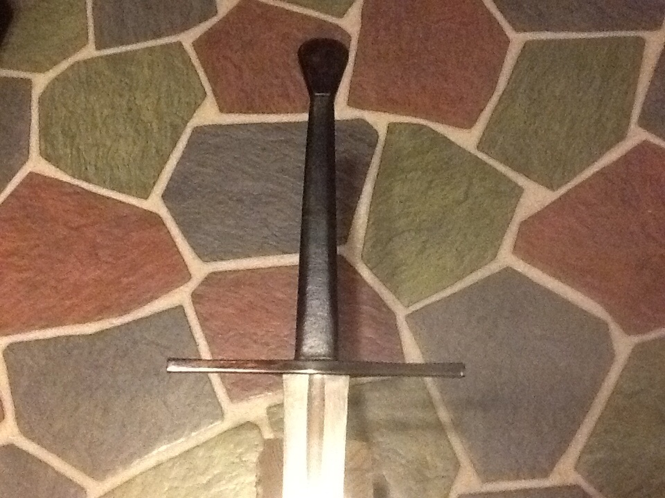

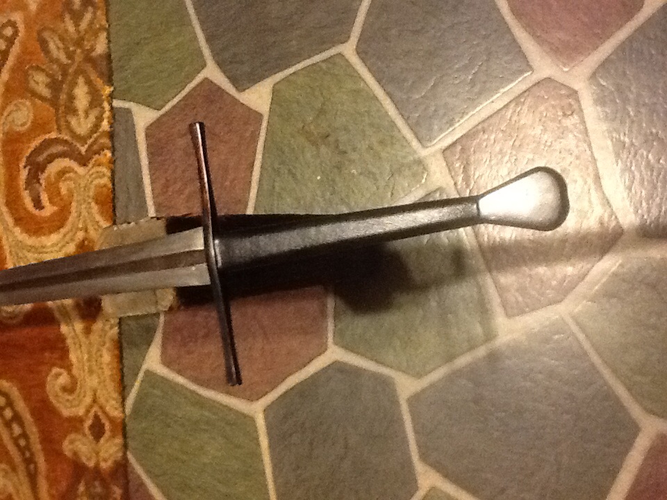

Matthew P. Adams
Location: Cape Cod, MA
Joined: 08 Dec 2008
Likes: 8 pages
Posts: 462
PostPosted: Fri 04 Jul, 2014 12:49 pm    Post subject:         Reply with quote
I darkened the furniture on my Hanwei tinker longsword with linseed oil. I basically treated it like seasoning a cast iron pan. Wiped on the oil, hung it from wire in my stove at 500 F. Repeat. After 3 coats it had a turtle shell look, and after five it came out pretty blackened.
 Attachment: 238.52 KB
 Attachment: 240.88 KB
