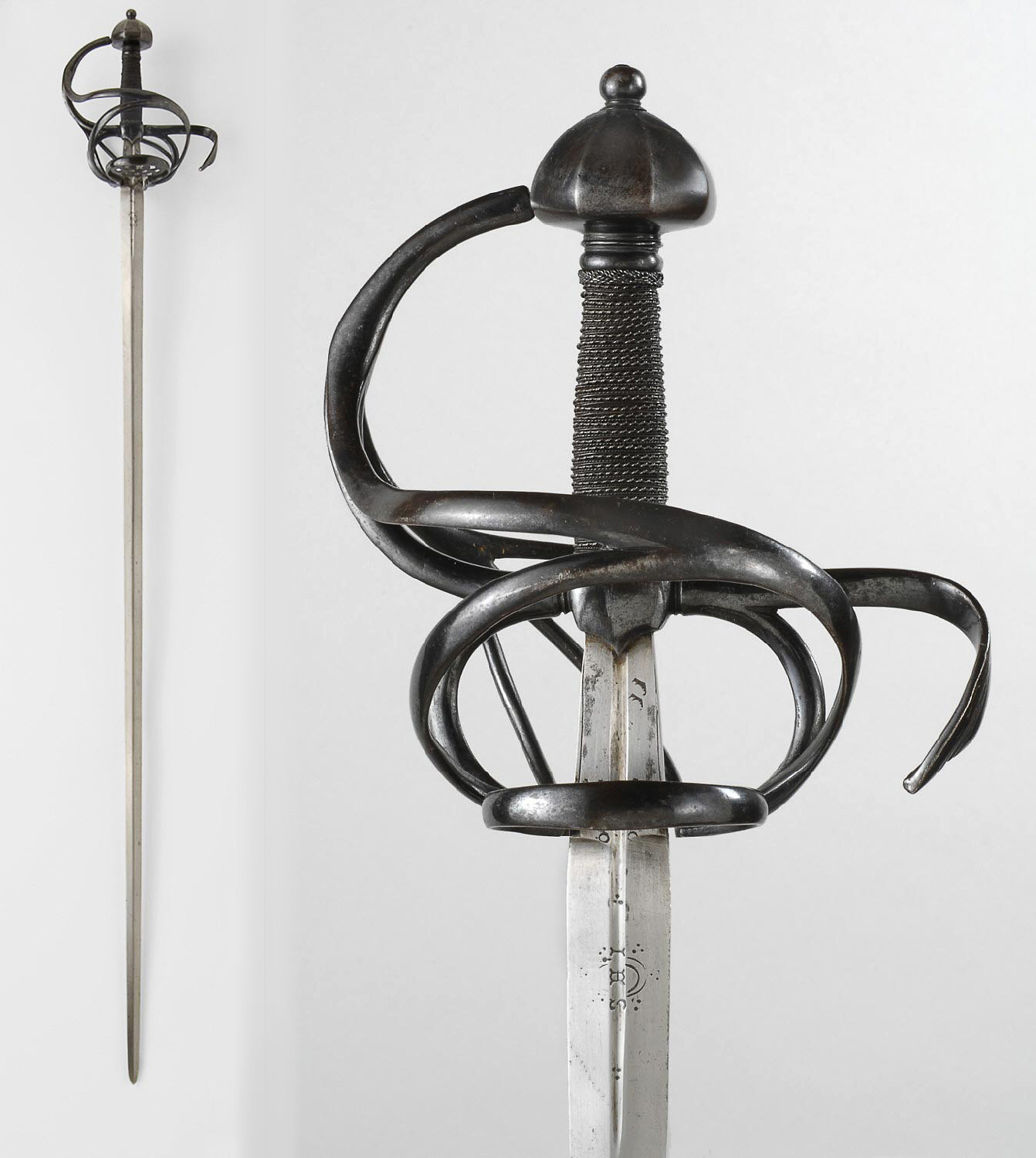

I can only agree with Craig - you´d typically call it a "swept-hilt". I also agree that their use couldn´t be restricted to a particular country - if you look around auction houses (my preferred choice is the Herman Historica, but there are many others) and museums, similar rapiers are called "German", "Italian", "Spanish" etc.
I´m attaching a picture from Herman Historica - this rapier is coming from Spain (at least, the inscription on the blade supports it), and the hilt has similar general design as the A & A Musketeer.
However, there is one difference - the A&A hilt features two pierced plates. This makes it slightly different also from the rapier posted by Nathan, which does not have the "triangular" plate on the back side. To me, these two plates make the A&A one look somewhat "German" (just a subjective feeling, because of some distant similarity with Pappenheim rapiers). I remember I have seen an original with the hilt like that somewhere, but I cannot remember where. When I find it, I will post it here.
As far as the blade is concerned, I have seen swept-hilts mounted with different kinds of blades - some slender ones, good for thrusting (see the one I´ve attached), some broad and pointy, which would be good for cut & thrust. As Craig said, the A&A version looks like the later.
