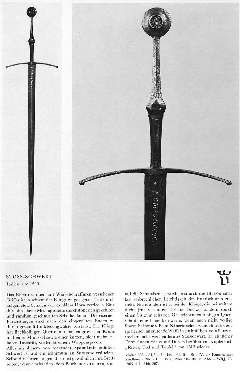

Regarding the grip section of steel/iron, I'm reminded of these swords.
 Attachment: 133.58 KB
 Attachment: 252.21 KB
