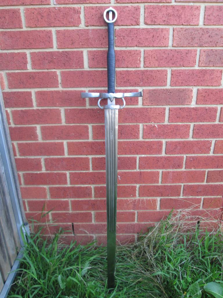

I have just taken possession of my first “real” sword, and wanted to give a review of the sword itself, and of dealing with Melbourne based sword maker Tim Harris (who is a member of this forum)
I will start with the inspiration for the sword itself. From the outset I must point out that while this is not a “fantasy” sword, neither is it a true historical piece. All of the elements are from swords from the 2nd half of the 16th century, and mostly Irish or Scottish. Due to the tyranny of distance (everywhere with swords is a long way from Melbourne, Australia) all research was done with the help of Professor Google. I found some examples of 16th century 2 handers with the ricassos that consist of a length of exposed tang (or at least, that seems to be what is going on in the examples I found), in particular a really nice example documented by the guys at Zornhau. Other than the ricasso, I approached the conceptual design of this sword as an amalgam of elements from Scottish Border Reiver and Irish Gallowglaich weapons. I envisioned it as the sort of thing a moderately successful, well travelled mercenary might have had commissioned from a local swordsmith using an import blade and putting together a bunch of things he had seen on swords in his travels and thought “looked cool”.
When trying to design the look of the sword I ran up against some significant issues, the biggest of which is that I have no experience or talent in either mechanical or graphic design, and no eye or hand for art. Playing around with a 3-d surface renderer gave some idea how different combinations would look, but it was very slow going. When Peter Johnsson shared his geometric module design ideas on this forum I read them with great interest, and attempted to use the idea to see if it would help.
The major challenge I had in applying Peter’s theory was that I did not have clear in my mind where, exactly, the blade began and the hilt ended, and I just could not get everything to work together, no matter what blade/hilt ratio I tried. I was listening to a Peter Gabriel CD one day while playing around with circles when I thought “Wait, what if I set the blade shoulder/hilt/fuller/forward siderings layout on a 7 circle scale, and the handle/cross/pommel on a 8 circle scale”. Tried it out, and was really happy with the result. The reason I mentioned that I was listening to Peter Gabriel is that the particular song was “Solsbury Hill”, I didn’t think much of this until a few months later when it was pointed out to me that this song is unusual in being in 7/8 time. Make of this what you will.
I did some of the initial construction myself. I bought some 5160 steel (surprisingly hard to reliably obtain here) and cut the blank from the stock using an angle grinder. Although I have made a few blades in the past, I found out that the laws had changed in Victoria since I had last done so, and there were now restrictions on making swords as well as those restricting selling them. This suited me fine as I realised that my very crude smithing skills were not really up to the level I wanted for this project.
I found Tim Harris through this forum, and after contacting him and talking through my expectations and his background decided he was an excellent person to hand over to. His prices were very, VERY, reasonable (for a normal longsword he charges less than what a Hanwei Bastard will cost you if you take into account the insane shipping prices one pays to get things here).
Dealing with Tim was a real pleasure. He practices HEMA as well as being a smith, so describing some of the
application stuff was easy. He was clear from the outset that he doesn’t do fantasy pieces, but was happy to work from my specifications. He was great in the communication department, providing suggestions where appropriate, asking for clarification, but letting the customer set the direction for the project. Pretty much everything one can hope for for a good working relationship with a craftsman. A not insignificant issue for those that live in Australia is that Tim also has the relevant legal exemptions to make and sell swords. The only thing in the “cons” column was that the actual production time was slightly longer than initially indicated. There were some mitigating issues here though. The first is that Tim prefers to forge, but due to having a pre-cut blank went the stock removal route for this project, and the “sure and steady” approach added to the time it took, and I am happy that he did. The other is that during the Christmas break, when he expected to get the bulk of the construction done, Melbourne had 2 weeks of days over 40 degrees. That is 104 for those of you that use Fahrenheit. Expecting work to progress under those sorts of conditions is simply unrealistic. Through this, Tim was excellent in keeping me updated, so even this “negative” did not detract in any way from the experience.
The Sword
All measurements are in metric
Total length 138 cm
Blade Length (to shoulders) 98cm (to cross) 103cm
Hilt (from front side-ring to base of pommel) 40cm
Grip 27.5cm
Blade width (at shoulder) 5.8cm (at start of point) 2.9cm
Triple fuller runs 58cm down blade, central terminates at 58cm
Blade is 5.2mm thick at ricasso , slimming down to 2.5mm near the tip
Flattened hexagonal at base, softening to lenticular towards the tip, stays true when held horizontal.
Weight is 2.48kg
Balance point is 10cm past the front rings, and the CoP seems to run for about 7-8 cm starting just past the end of the fullers.
Blade is 5160, cross is mild steel, and the pommel is reclaimed and re-purposed 100+ year old wrought iron. I didn’t know about this feature till I picked the blade up, and it was a nice touch that I feel really added something.
Tim normally does a mirror finish on his blades, but I asked him to pull back to a bright satin. No machining marks, but some polishing marks still visible.
Impressions
I was a little giddy when I first held this sword in my hand, it was something that had been taking up a lot of mental real-estate for a long time, so to see it fully realised in steel, and exactly as I had pictured, was quite thrilling. The overall finish was good. True, there are little things that are not “perfect”, but they are in the realm of “character building” rather than flaws. For the price point I felt the finish was very good. Truth be told I would have thought the finish acceptable on a custom sword twice the price. The added touch of the reclaimed wrought iron for the pommel is a nice touch, and I think one that forms a nice link with the past.
I won’t lie, at two and a half kilo, this sword is no lightweight. However, the balance is good, to the point that my better half, who has little experience with swords, expressed surprise at how light it was. The balance is such that the blade can be held one handed in a high hanging guard, like those from Morotzo, without feeling like your arm is going to break. That said, it is a dedicated two-hander. In movement it is very lively, moving from guard to guard is as easy as with my hanwei bastard sword trainer. This surprised me, but after a few minutes swapping back and forth I was satisfied it was not just a first impression. I was more tired after using the new sword, but the responsiveness was very similar.
I will preface this next bit but stating that I am whatever is before novice when it comes to cutting. I have done a little bit of light cutting with Katana like objects, and nothing with western style blades (this was part of the drive for this purchase). I have only done a small amount of cutting with this sword thus far, using two litre milk bottles filled with water, but the experience was illuminating. The sword was very easy to get moving, I was quite conscious of not over committing etc, but the velocity the blade seemed to reach with no real effort was a little frightening. Stopping the cut was a different matter, once this baby got going she did not want to stop. My first ‘non-practice’ swing left me a little shocked, the difficulty arresting the movement was scary, and it was only after I recovered from that that I realised that I had felt literally zero resistance from the bottle. I know milk jugs are not a difficult cutting medium, but the ease with which these ones were polished off was a somewhat frightening.
Conclusion
I can heartily recommend Tim Harris to anyone thinking of having a sword made in Melbourne, or elsewhere in Australia. Easy to deal with, great quality work for his price point, what else could one want. As for the sword, I love it, and I am a little afraid of it at this point. There are a few things I am thinking of tinkering with, such as etching something historically accurate onto the blade, evening out the finish, or making an Irish fringed scabbard, but even as is I really couldn’t be happier. I am sure that as I develop more of a working relationship with this blade that I will come to appreciate more aspects of its handling, but I am already a fan.
Will upload some more pics as lighting conditions/improved camera handling permit

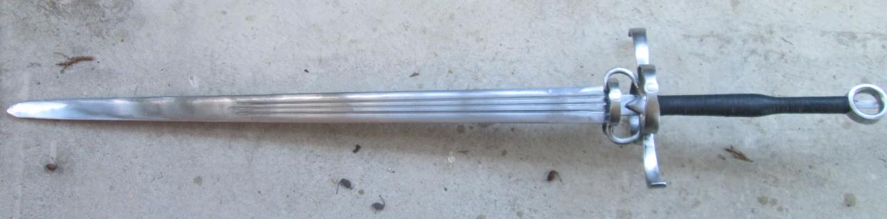

Horizontal view of entire sword [ Download ]

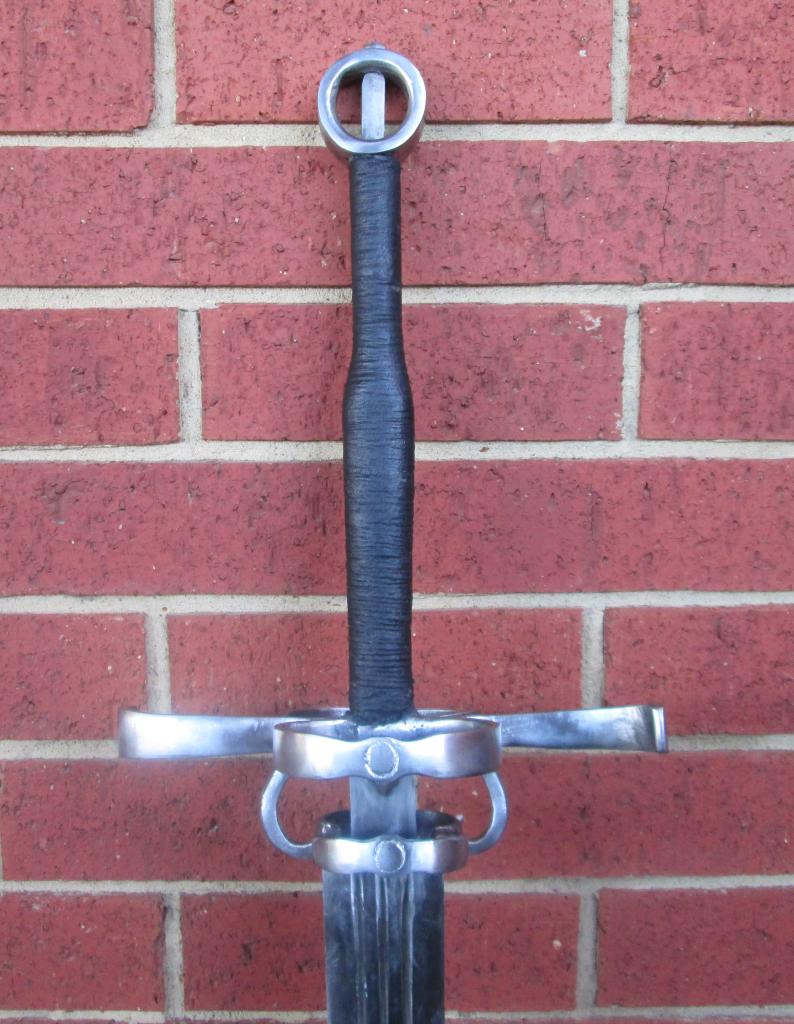

Close up of hilt [ Download ]

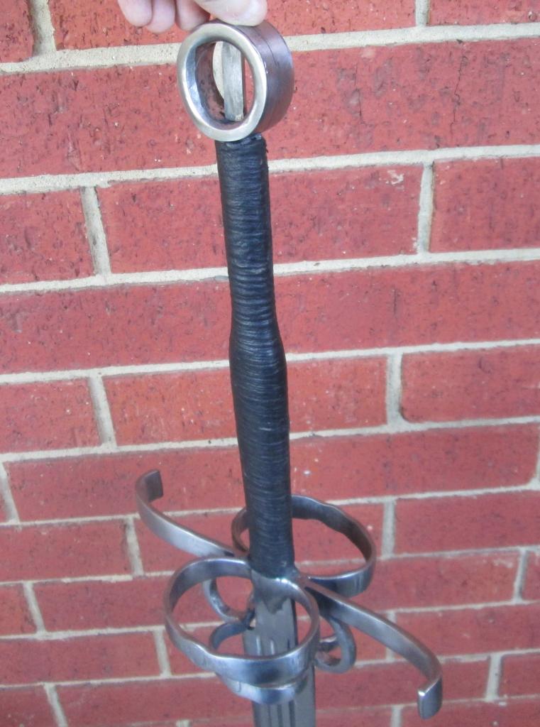

3/4 view of hilt [ Download ]

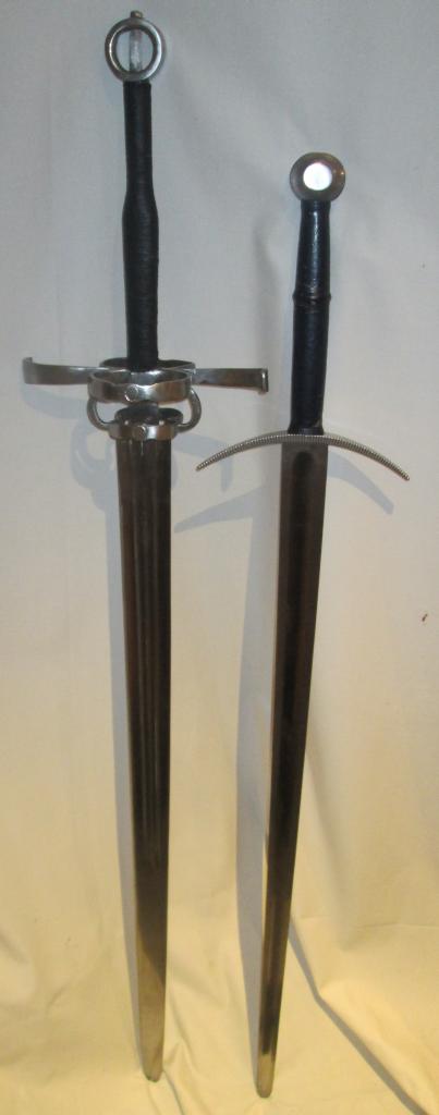

A comparison with a Hanwei Bastard, and one in the hand of a very chuffed owner

Stephen Curtin wrote:
I hope you don't take this next piece of nit-picking in a negative way, but to my untrained eyes the pommel looks a bit small in proportion to the rest of the sword..
Not nit-picky at all, you make a good observation. It is partly an artifact of the exact shape of the pommel not showing up well in photos. The flat surface of the pommel is inly about 6-7mm wide, so in the photos, esp because of reflections, it looks quite delicate. "in the flesh" though, there is actually a sort of "bevel" before it reaches its actual thickness, which is more like 10mm or so. It is also quite thick top to bottom, so the actual ammount of material is greater than the photos show. The long handle also means that what weight *is* there has a longer lever to act as a counter-weight.
