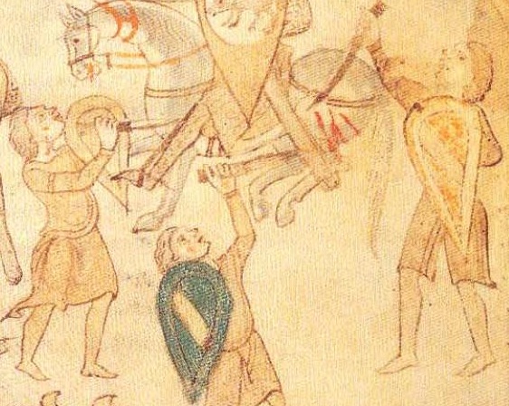

Craig Peters
PostPosted: Mon 28 Apr, 2014 9:39 am    Post subject:         Reply with quote
Initially, I resisted the idea of the image depicted a seax, because I thought that 1160-1180 AD would be too late. While it could be true that the relief is incorrectly dated by the Foto Marburg, it's not impossible that the weapons depicted really are seaxes at such a "late" date. Re-browsing the images from Manuscript Miniatures, I came across the following image from the Liber ad Honorem Augusti, which dates to around 1194-1196. While I would like to be able to find evidence of some form of daggers, I am hard pressed to state that the weapons shown here are anything other than seaxes. Further, the figures who wield them seem like they might not even be knights.
The situation is somewhat frustrating to me; on the one hand, there seems to be reasonably clear evidence of daggers looking at numbers 2 and 4 from Hrabanus Maurus, regardless of whether the other weapons shown are daggers or not. On the other hand, it seems like the only 12th century images I've been able to locate thus far invariably show some form of seax. Are there quillon daggers or any other form of dagger at all in the 12th century? If not, have we misinterpreted the evidence from Hrabanus Maurus?

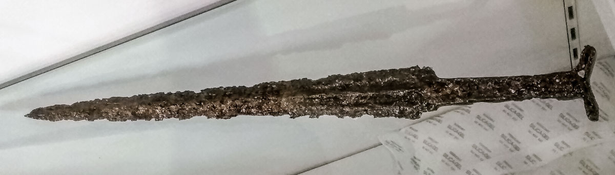

PostPosted: Sun 17 Feb, 2019 5:40 am    Post subject:         Reply with quote
I've been meaning to contribute this for some years.
Attached is a photo of a dagger in Moyes Hall Museum In Bury St Edmunds, Suffolk.
It's in a 1903 museum catalogue as being found at the site of the battle of Fornham just 3 miles from the museum.
That battle occurred in October 1173.
If the find record is correct and I've no reason to doubt it, the site has produced a couple of swords, spears and arrowheads over the years, then we are possibly looking at an actual 12th century dagger.
The river Lark (which was quite a busy trade route in the past) passes by the the site, so it's not inconceivable that it could have been lost in later centuries but i'm not expert on dagger forms through the ages, so whether it matches known known types of any date i'll leave for you all to decide.
It's approximately 300mm long and 30mm at the widest part of the blade. Diamond blade profile with two narrow fullers running from the grip for about a quarter of the blades length.
Hope this is of use, interest to some.

PostPosted: Sun 17 Feb, 2019 1:13 pm    Post subject:         Reply with quote
Clearly, that's a 14th century baselard.

PostPosted: Sun 17 Feb, 2019 2:20 pm    Post subject:         Reply with quote
I agree with Mart (though could be 15thC), no way is that 1173

Craig Peters
PostPosted: Sun 17 Feb, 2019 7:26 pm    Post subject:         Reply with quote
Hi James,
I want to approach this dagger slightly differently from how Mart and Tod responded, looking at limitations of this approach to dating the dagger.
When weapons or other artifacts are found and alleged to be from the site of a battle, we need to be cautious in assuming that this definitively provides a date. One thing I would ask is whether this dagger was found at precisely the location of the battle, or nearby. While “nearby” might sound like almost the same thing, it’s not, and there’s much greater possibility if the artifact is nearby that is does not date to the time of the battle. Secondly, the other swords and artifacts need to be considered: can they be given a fairly confident date of belonging to the 12th century based upon form and style? Or was the attribution of date made because of proximity to the battle site? Was the dagger found side by side with the other weapons, or could it belong to a different strata of the soil, and perhaps also to a different period? Has anyone done metallurgical analysis of the artifacts in question?
Both Mart and Tod have responded that this dagger looks like a baselard, and I agree with them. Nevertheless, even if we assume it could be some other form of dagger, there is another attribute that makes the 12th century date unlikely, which is the double fuller. Double fullers are exceedingly rare (if not non-existent) on swords from the 12th century. Therefore, to find a dagger with a double fuller suggests that the weapon is almost certainly 13th century, if not 14th or 15th century.
In conclusion, even if we don’t simply assume the dagger is a baselard, there are methodological problems with assuming a 12th century date, based upon proximity to the site of the battle, alongside the problem of double fullers. Therefore, I do not think we can reasonably date this dagger to the 12th century, based upon present evidence.
Leo Todeschini
Location: Oxford, UK
Joined: 12 Nov 2006
Posts: 1,707
PostPosted: Sun 17 Feb, 2019 11:51 pm    Post subject:         Reply with quote
Thanks Craig for reminding me of the evils of brevity.
Craigs response is completely correct, but also more importantly it is useful and balanced and helps to take the knowledge and study of the area further; whilst my reply, although correct, is also more or less useless.
Thanks for the lesson and is a demonstration of exactly why this site so so damn useful.

James Rayner
Joined: 20 Oct 2005
Posts: 2
PostPosted: Mon 18 Feb, 2019 2:07 am    Post subject:         Reply with quote
Thank you all.
I knew nothing about daggers (from any century), i now know ever so slightly more than nothing.
I've always had my doubts about this. It's been displayed with the other Fornham artefacts for as long as I can remember, I suspect out of ignorance.
Nothing is really known about it, precisely where it was found, how deep etc. It was found at a time when less care was taken in recording such things.
Craig, as to the other finds from the site, specifically the swords, one is in Oakeshott's " Records". Though he's hesitant to say it's a relic of said battle, despite it being the right age. The other is a similar type, but not a lot is known publicly. It was only found a couple of years ago and is now in the care of the British museum.
I'll pass some of this along to the folk at the museum in the hope it can be correctly labelled.

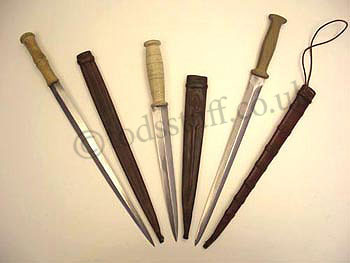

PostPosted: Mon 27 Apr, 2020 5:37 am    Post subject:         Reply with quote
Craig Johnson linked to this great thread from A&A's blog. It's a great resource. In an effort to add a little to it, here is a dagger and its reproduction from this thread. The original is dated 12th-13th century.
There are at least a half dozen pommels of the form on this dagger pommel. There are also a number of lozenge-shaped pommels and scalloped-edged round pommels, plus a couple with crown shaped pommels and other forms. A description and more pics can be found in this article from the Metropolitan Museum Journal. The article dates many of them to the 12th-13th century and frequently labels them "probably French." All the pommels--a couple dozen from that article--are cast bronze (often hollow) and most were found in and around the Holy Land. They appear to be decorated with enamel, which probably adds to the "probably French" attribution. Another article in the thread linked above shows another set of related bronze pommels found by metal detectorists in the UK.
While it's impossible and illogical to say that 12th-13th century daggers had to have a bronze pommel based on this sample set of data, making a reproduction dagger with a bronze pommel of these forms wouldn't be odd. Happy Blade forms are more speculative, as we have the Met example as the only complete, documented dagger. The dagger posted by Cornelis Tromp (who collects antiques) in the thread has a pommel of this form, but the guard's shape/coloring/patination give me a little pause. I wonder if it wasn't a later addition to "complete" the piece. I have zero documentation to back that up, though. it's more a gut feeling.

PostPosted: Mon 27 Apr, 2020 6:16 am    Post subject: Excellent addition         Reply with quote
Thanks for posting that Chad. That is an excellent addition to this thread and the research. When seeing Josh work on these pieces I was amazed at how small they were. (one of my constant blind spots, period stuff is usually smaller than we assume, constantly have to remind myself to check the actual specs).
One of the interesting aspects of these particular pommels and the dagger is how they are not just basic forms. It illustrates that even at this early date our basic modern western concept of everything has to evolve from simple to comlex or plain to fancy is probably not the truth of the matter.
I should have remembered to add this to the thread a while ago. I fear it gets to busy sometimes :-) But I am always on the look out for more evidence to contribute to this story of the early cross hilted dagger.

PostPosted: Mon 27 Apr, 2020 6:52 am    Post subject: Re: Excellent addition         Reply with quote
The one Josh made for me isn't very large and was sized up from the original. Again, we only have the Met dagger to go on as a complete example with specs, but it's tiny, relatively speaking.
