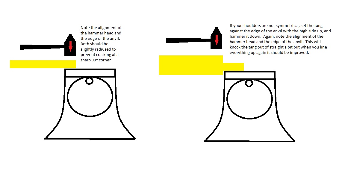

hello everyone I've recently started learning to forge medieval armor and weapons. I've been trying to create knifes/daggers so far and I'm having trouble drawing the tang out and keeping it center are there any tips that you can offer me in how to do this more effectively as well as any forging tips in general

Addison C. de Lisle
Location: South Carolina
Joined: 05 Nov 2005
Likes: 27 pages
Posts: 614
PostPosted: Sat 15 Mar, 2014 10:26 am    Post subject:         Reply with quote
Practice your hammer control and do it over the near edge of the anvil, lining up the edge of your hammer with the edge of the anvil. Made sure both are slightly rounded so you don't get a sharp, 90* corner that is likely to form cracks. If it's slightly off-center, put the high side up, get it to a high heat (yellow), and put in back on the anvil the way you started, and hammer the high side down. When you straighten everything out again it will be closer to where you want it. I've attached a quick diagram I made with Paint (forgive the crudeness).
This takes a bit of practice but you'll gain more in hammer control by practicing this technique.
