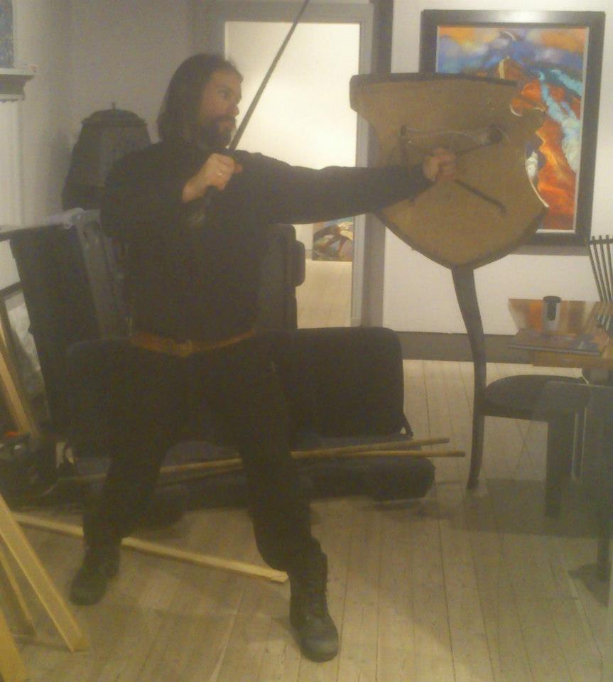

Center gripped heaters show up every once in a while. After all, the arrangement of shield straps is a matter of personal preference, and if you are in doubt you can simply mount more straps.
First of all, check the strap arrangement on you current heater. Does it cover your shoulder when you stand in your relaxed guard? If not, move the straps. Put the shield so that it covers you shoulder or cheek, hold up your arm to where it naturally rests, and put the straps there.
Do not hold the shield flat across the body, angle it 45 degrees forward, and put your hand behind the front corner. You now have a very strong guard that allows for quick strikes at your opponents upper targets (whatever hit zones you are using)
Protect your legs by extening the shield forward and slipping your leg back rather than lowering the shield.
If you still want a center grip, the easiest way to do this is to mount two long, vertical straps on either side of the shield center. When gathered in the hand, these provide a very firm grip and much better edge controll than a regular handgrip.
Below demonstrated on a small heater, but should work on larger ones as well.
 Attachment: 61.97 KB
