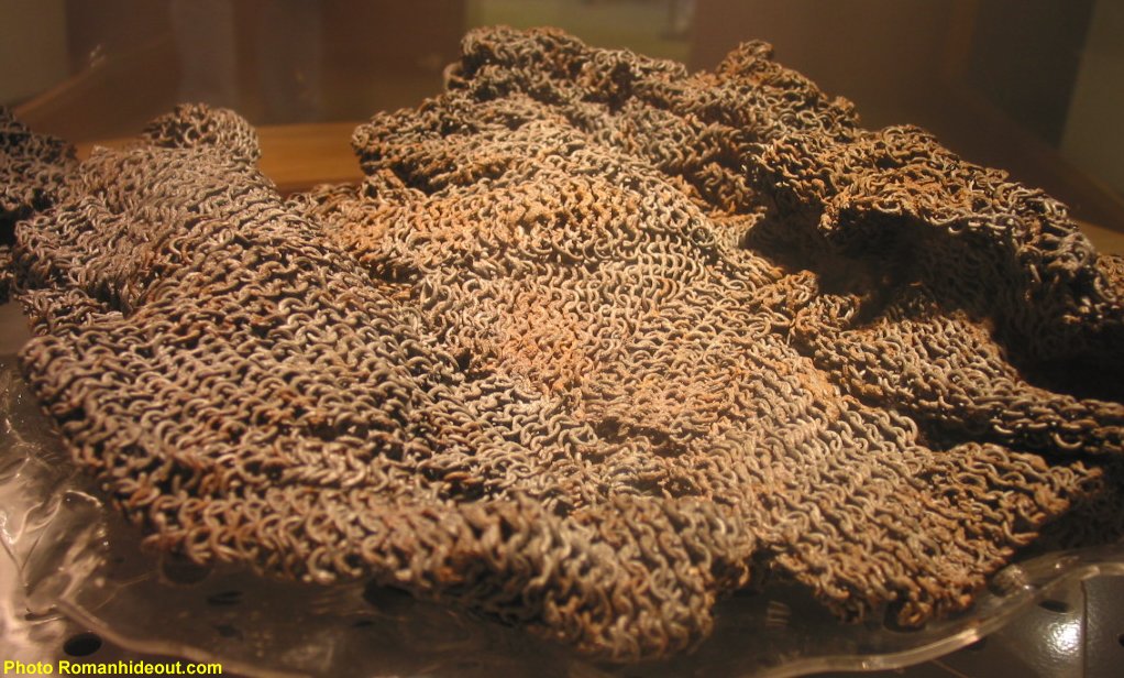

The Arbeia hamata seems to have been pretty typical of Roman mail and it is in very good condition. The thickness of the wire compared to the link diameter is very high - resulting in a density that is better than a lot of surviving medieval mail. It was a very substantial armour and easily capable of stopping any threat the Romans faced in battle.
Even if you pay attention to the OPs claim and falsely assume that Roman mail was of a lighter variant, these variants are still far superior in protective capacity to an equivalent weight of hardened leather. The people who push the above reasoning have no idea how real armour actually functions (they seem especially ignorant of the functionality of properly riveted mail). This is the problem with letting arts graduates like D'Amato dominate the field who don't have the right background. I'm an arts graduate but that wasn't till I was in my thirties. Before that I was exclusively studying science and engineering and thought that arts students were academic lightweights who didn't have the mental capacity to get a "real" degree. Now I realise that you need both disciplines to properly study this subject.
