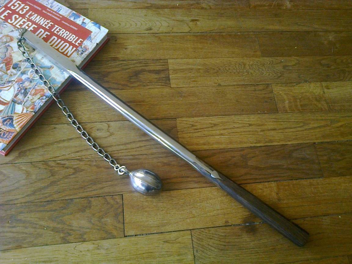

Here's for your consideration - apologies for the quality of the photo, it's all I can do given my current (complicated) situation...
Again, a piece made with the History Market of Pontoise (in 2 days...) in mind.
A Flail, made after the one in the Viennese Rüstkammer (A 177, ca. 1515), although somewhat thinner. 60,5 cm for the haft, and the ball is 40 mm thick - and all hand filed from round stock.
The chain is, unfortunately, modern, as I had to take shortcuts due to time constraints - but it has been polished, and slightly hammered to shape (ie given strengthening the twist) ring by ring, all by hand.
Wood is oak, slightly darkened, and the langets (although not much visible on the picture) are thinner near the top end, as is regular on such construction.
The book also might be of some interest to those of you who can read French, as it is an in-depth study of the siege of Dijon in 1513, to which I contributed (on arms and armour...).

PostPosted: Thu 10 Apr, 2014 1:22 am    Post subject: Re: A Flail         Reply with quote
Fab
PS perhaps more, and better pics will follow.
what is the height, and weight of the ball as well im curious about flails, specifically ones used by 10th century black sea horse nobles, but replicas give me at least some idea about dimensions of handles etc

PostPosted: Thu 10 Apr, 2014 6:44 am    Post subject:         Reply with quote
The ball is about 70 mm im height, ring included, and as said 40 mm in diameter. I couldnt weight it though as I have no scale here, sorry...

PostPosted: Mon 21 Apr, 2014 2:59 pm    Post subject:         Reply with quote
As promised : better pic.
