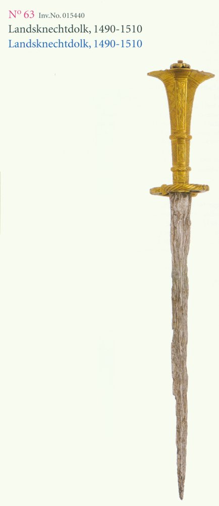

the classic "Landsknecht style" dagger would be two-edged blade, most likely diamond section, though hexagonal or square reenforced tip is possible, a calyx-form hilt most likely of copper-alloy, with a tightly coiled "S" profile lower guard.
Example from the Delft Legersmuseum collection:

Hi Lance,
I would agree with James, that that is the 'classic' Landsknecht dagger, however there are plenty of other choices.
They did seem to like all metal hilts, so the almost delicate all steel rondels are very typical. Wallace and most good arms collections have these.
The flamboyant was also welcome, so the designs of Holbein and Durer were popular.
They liked fishtail pommels as shown in their Katzbalgers and so there were dagger forms that had these, often very fine and delicate and with some form of ring guard and on one side and nothing on the other. Look at the Met and the Army Museum in Paris.
They also liked very funnel shaped grips that start fine and grow very bulbous as they go to the top. Wallace has a few.
I posted up a few pictures of retros I have done, but I think they may have been taken down (sorry) as it is more or less against the rules, but I can't locate many original pics right now and don't have the time to dig them out.
I hope that helps, but you have quite a choice.
