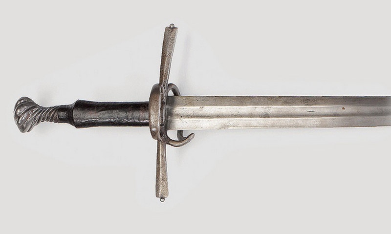

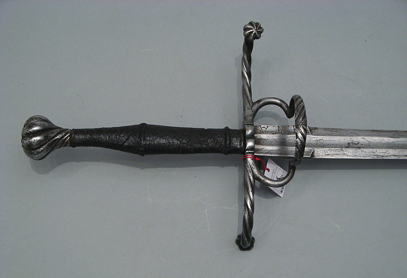

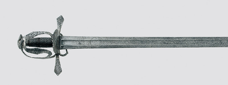

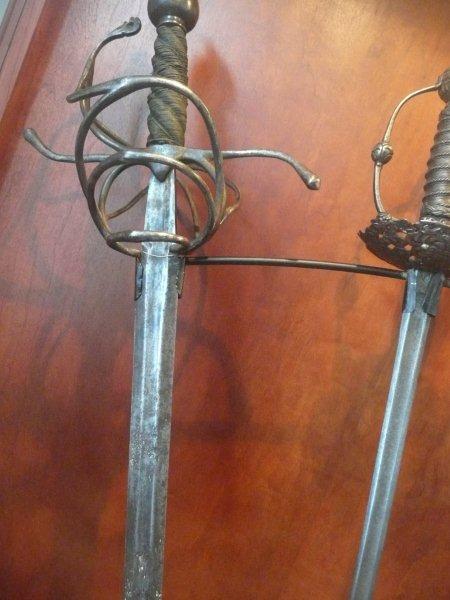

Just a few comments and examples:
Compound-hilted swords are not by definition fragile at all. Most aren't dainty or flimsy or wimpy. They're more often very rigid and stout. Oftentimes, compound-hilted swords are beefy and heavy compared to a similarly proportioned cross-hilted swords.
I think you framed your sentence well, but for those who might not get the distinction I'd caution not to clump all compound-hilted swords into the same discussion/sentence/context/category as rapiers. Rapiers are are specific type of sword that happen to have a complex/compound hilt. There is however a tremendous variety to compound-hilted swords ranging from very lightweight purpose-specific weapons to very heavy war swords.
To the issue of fullers one must understand that adding a compound hilt to a sword creates weight in the hilt. As such, oftentimes a stout blade with a good amount of mass is required to make a dynamically sound weapon. This goes to demonstrate my first point about these swords not being fragile or dainty!
Of course, as blade lengths increase the need to remove mass from them over the length might be required and so fullering might be a means to do this. There is a tremendous variety to fullering on compound-hilted swords including ones with wide and long fullers, multiple (3, 4 or even 5) fullers, and many more configurations.
I wouldn't consider the Albion Maestro Line "Marozzo" practice sword as having a particularly wide fuller. Some katzbalgers have fullers practically as wide as the blade itself! I'd also not call the Marozzo a rapier.

Nathan, thanks so much for the reply. Every time I read a thread on this forum I am reminded how much I DON'T know about medieval weaponry. I appreciate the clarification about the robustness of various complex hilted swords. You're right, when I compare them, a saber or cutlass don't seem the least bit fragile like a rapier or foil. I'm basing this solely on appearance since I've never held one.
The top photo you linked is phenomenal. What a gorgeous sword! Before I wrote this thread, I was looking at my Albion Sempach hanging on the wall next to me, and thinking how cool it would be to mate that blade to a complex hilt exactly like the Marozzo. Then I read your post and the very first photo I see is a Type XVII blade like the Sempach, on a complex hilt.
I've seen the wide fullers you're speaking of, and you're right that I probably should have called the Marozzo's fuller "medium width". I was picturing in my mind the Arms and Armor "German Rapier", which has a very narrow fuller, which made the Marozzo's seem wide by comparison: http://armor.com/rapier163.html
The Marozzo is such a fine looking weapon in many ways. As I said, I like the combination of the blade and the complex hilt, but I also like the shiny blade against the pewter colored hilt and light grip color. If Albion is listening, stick a narrow Type XVII blade on the Marozzo hilt and you'll have at least one very happy buyer.
The third sword down is amazing. It could have come right off the pages of a fantasy novel.

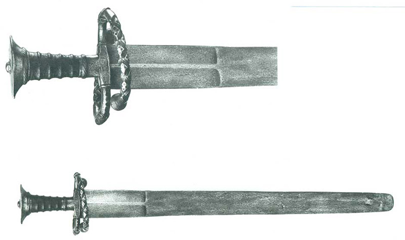

Posted: Sat 08 Feb, 2014 12:41 pm Post subject: |

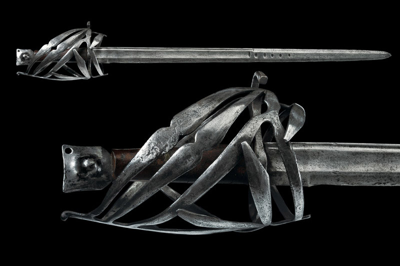

I found a more traditional style rapier hilt with a wide fuller in the blade. The sword is quite long, over 100 cm and the blade is just under 4 cm wide. The fuller is very wide and almost the length of the blade. The blade is marked with a crude running wolf symbol. I'm sure there are other examples.

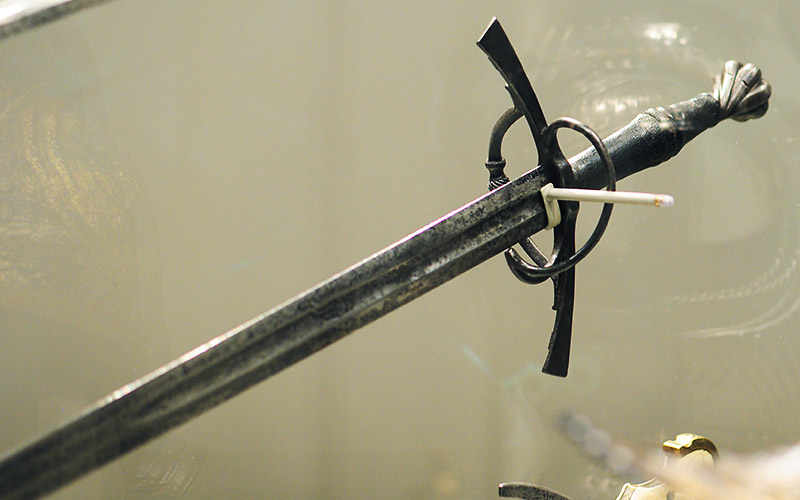

Will Phillips
Posted: Sat 29 Feb, 2020 7:47 am Post subject: |
My apologies about replying to a six year old thread, but Nathan - or any others - can you speak to the provenance of this sword that was shown above?
Those Styrian baskets and half-baskets are a particular interest of mine.
