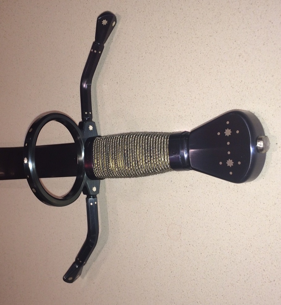

Alex Indman
Location: NYC
Joined: 13 Sep 2012
Posts: 188
PostPosted: Thu 06 Oct, 2016 7:15 am    Post subject:         Reply with quote
Hi,
resurrecting this topic to post the results of applying the discussed technique to my latest project. I made a complete set of fittings (guard, pommel, handle collars) out of 1018 mild steel with fine silver inlays.
As I expected, anything attached with regular solder wasn't compatible with heat bluing at 550F in my oven. But the high temperature silver solder that I used for the collars (working with it was more like brazing than soldering) held up just fine.
Took more time for more massive parts to achieve same color: almost 1.5 hrs for the guard and 2 hrs for the pommel.
Color is quite consistent all over, deep black-blue with some purplish highlights, depending on light. See the attached picture, unfortunately not greatest quality.
Happy with the result, thanks everybody for the suggestions given here!
Alex.
 Attachment: 239.7 KB
Greg Ballantyne
Location: Maryland USA
Joined: 14 Feb 2011
Posts: 235
PostPosted: Sat 08 Oct, 2016 8:18 am    Post subject:         Reply with quote
That turned out very nicely Alex. I'm surprized at the deep even color, and the inlay really stands out.
Alex Indman
Location: NYC
Joined: 13 Sep 2012
Posts: 188
PostPosted: Sun 09 Oct, 2016 9:04 am    Post subject:         Reply with quote
Honestly, I was surprised myself... And if not for Tim here, I wouldn't even think about using the oven!
Alex.
