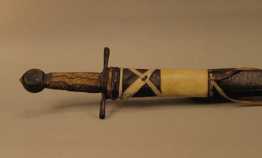

Here is a example of what I am talking about. This is from my research on 12th Century swords (Oakeshott XI-XIa swords). Please add corrections and comments, if you can. I am slowly working on similar data for other sword types.
SWORD BELTS
Sword belts of the 12th Century (corresponding to Oakeshott XI and XIa swords) are all wide, white or very light in color (buckskin?) and fastened by knotted thongs (figure 1). The belts are undecorated and do not have any mounts. However, one illustration from the late 12th Century shows a white sword belt with a linear array of round dots (figure 2).
Figure 1: A typical 12th Century sword belt. It is made of a wide, lightly-colored leather and fastened by knotting a thong.
Figure 2: A linear array of dots on a wide white sword belt (Germany, AD 1168-1189).
Curiously, one illumination from 12th Century Italy shows soldiers carrying their scabbards hanging from their forearms (figure 3). This could represent soldiers rushing into battle before they had time to put on the belts.
Figure 3: All four soldiers with scabbards hanging from their forearms (Italy, AD 1100-1200).
SWORD SUSPENSION SYSTEMS
The white sword belts are always integrated (laced) into the scabbard. The integrated white straps are laced in an "X" or backwards "Z" pattern (figure 4). Sometimes the tails are knotted on the outside of the scabbard and the tails hang like tassels (figure 4, right).
Figure 4: Typical "X" or backwards "Z" lacing patterns on 12th Century scabbards. the image on the right shows the hanging tassels.
SCABBARDS
Presumably 12th Century scabbards are covered with leather, generally dark brown. Rarely the scabbards appear to be the same light color as the white belt. No other colors were seen, although many illustrations are in black and white. Integrated rain guards and metal chapes do not appear in illuminations until late in the 12th Century (figures 5 and 6). The chapes are all simple. Other features, such as leather tooling, risers, rings and lockets, are not found on 12th Century scabbards in the illuminated manuscripts.
Figure 5: Integrated rain guards on late 12th Century scabbards (Germany, AD 1180-1200).
Figure 6: A simple metal chape on a late 12th Century scabbard (Spain, AD 1197).

Just a technical point, if a skin has been prepared with alum, then it is tawed, not tanned.
The previous discussion on white belts is here:-
http://www.myArmoury.com/talk/viewtopic.php?t=13560&view=next
