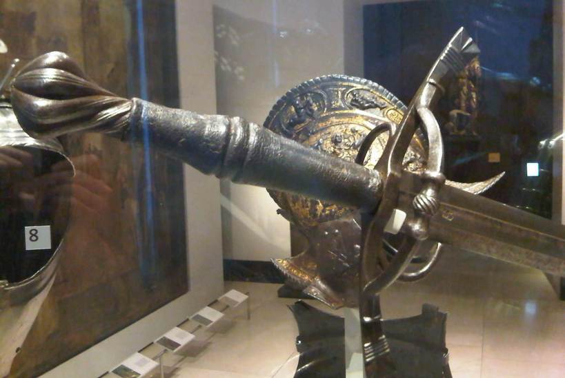

I imagine I would prefer a sword less substantial than either of these. The DT 2160 is a lovely sword, but a bit later in the century. I'm more partial to the detail of the twisted forms seen in the early part of the 1500's, or the plainer, more skeletal hilts. I've seen multiple historic examples on this forum of swords that inspired the DT 2160, and the result to my eye doesn't capture any of the balance of the originals. I've attached one below (Image 1) with features that seem to be very consistent. The pommel on the DT 2160 is uninspired.

I think Image 2 attached below has a hilt closer to my ideal were it paired with the a different blade. Straight quillons with twisted detail and a simple finger ring. The pommel is elegant but not overwrought. The grip could have more waist to it and a riser or three. This is probably from the first quarter of the 1500's. Does anyone know the location of this sword?
