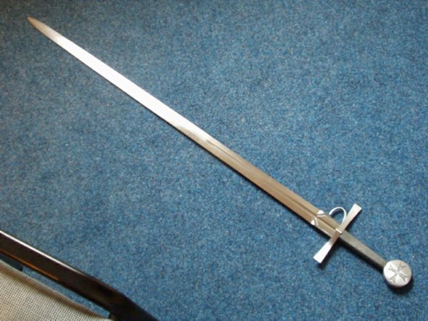

PostPosted: Wed 01 Oct, 2003 12:34 pm    Post subject: Re: This brings up something else.....         Reply with quote
Björn Hellqvist wrote:
It's the sword from ALexandria http://www.myArmoury.com/feature_alexandria.html. The stats are as follows: Blade thickness at base: 0.2" (5mm), 4" (100mm) from the point: 0.1" (2mm), 1.6" (40mm) from the point: 0.1" (2mm, reinforced). The reinforced tip starts 40 mm from the point, which means that it isn't 0.1" all the way. It is possible that the reinforced point was intended for armour-piercing thrusts.
For what it's worth, when I commisioned ArmArt to make a replica of that sword (using Bjorn's stats), Pavel was a little nervous about starting the blade out at 5mm. We decided to start it out at 6mm and taper down from there. They didn't do the tip reinforcement. Overall distal taper - 58%. It is a little heavier than the original, but still a mighty fine sword.
Below, another gratuitous picture of my ArmArt Alexandrian sword:
