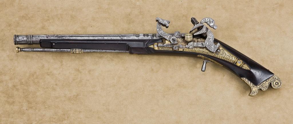

This comment is not in the same vein of course as it deals with a firearm but it does point out that Victorian copies can be quite good. In this case the copy is of an early 17th c. Scottish snaphaunce pistol. This one closely resembles one pictured in the Blair/Woosnam-Savage book on Scottish firearms. I think it does point out how clever Victorian craftsmen could be when the applied themselves. As we all know, not that many of them actually did.
 Attachment: 70.48 KB
