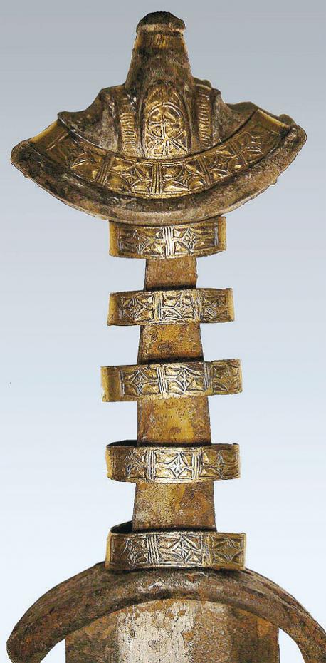

Tim Lison wrote
WOW! That sure is pretty! I love the blade and the alternating inlay is excellent. I haven't seen a pommel like that, do you have any photos of originals you used as inspiration?
Yes. I used this sword and another from Durham as inspiration. p74, 75, 76 from 'Swords of the Viking age' there is another from the Witham, but I can't find the picture right now.
Re-reading the book it states that these were considered to be Saxon, but are now considered to be more likely Viking.
The picture shown is from the Musee de L'Armee in Paris.
Ahh. I have never really loved the early Type L pommels so hadn't looked at them that closely. I may have to reconsider after seeing this. Is this the sword from the Whitham..?
