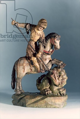

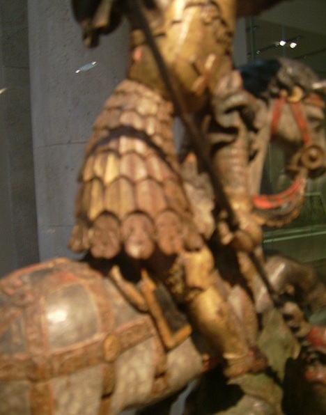

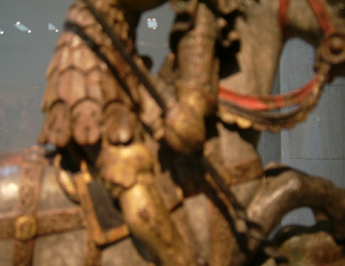

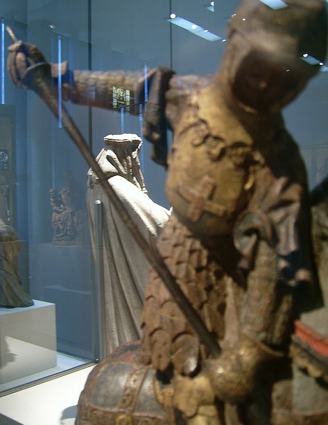

I am trying to work out the details of the armor presented in the pictures of the statue below. The statue is identified as St. George fighting the dragon, from Maasland, c.1390-1400 held at the Germanisches National museum in Nürnberg.
If anyone can provide any better quality pictures than those below I will be very grateful.
The following are the points that I feel reasonably confident on:

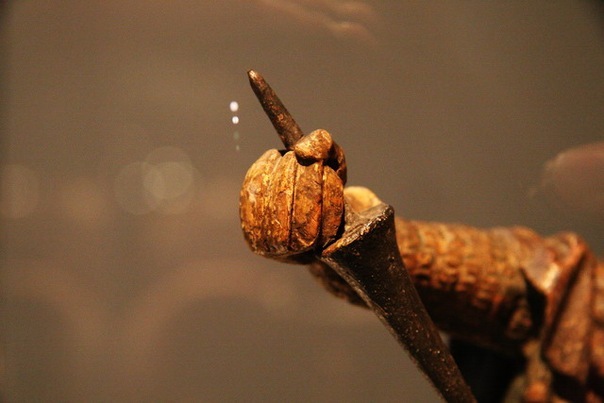

The breast plate is a kastenbrust. The helmet is a great bascinet with a high hinged front plate covering the throat. The arms are covered in a full sleeve of maile, but nothing else except for the loose sleeves of a shirt. A pair of mitten gauntlets protects the hands. A skirt of scales rests atop some sort of support garment, or possibly just the bottom of the shirt obscuring the upper legs. The poleyns appear to be articulated, and mail is visible at the back of the knee. The lower legs are covered by cased greaves.

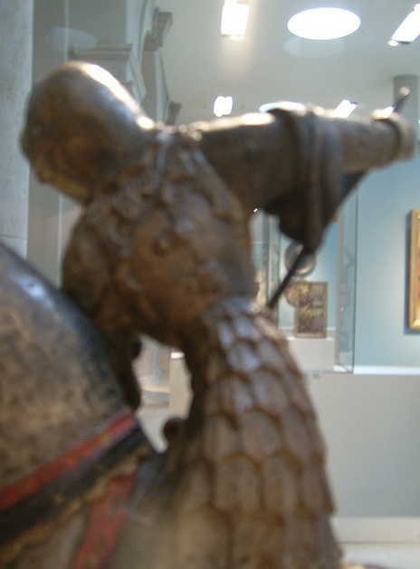

The problem I have is when I look closely at the breast plate. The color shift on the figures side suggests that the breast plate only covers the front and part of the sides of the torso. But what about the rings that encircle the arms? They look like a sort of trim work, like brass work on gauntlets except that they extend all the way around the arms. The buckles in the center of the back also leave me with questions.
The idea that these questions have left me with is that the breastplate is attached to pieces of leather or cloth which cover plates that protect the figures back and are buckled there to secure the whole arrangement. The puzzling rings are merely the edges of the leather or cloth folded back onto itself or over the breastplate as appropriate.
Does this seem reasonable? Further is there evidence to support this idea?
Any comments welcomed. Happy
 Attachment: 83.26 KB

there is a lot of depictions of scale faulds
http://manuscriptminiatures.com/4369/9228/
http://manuscriptminiatures.com/4164/7645/
http://manuscriptminiatures.com/4222/8939/
http://manuscriptminiatures.com/4223/8967/
http://manuscriptminiatures.com/4324/9535/
http://manuscriptminiatures.com/4344/9576/
http://manuscriptminiatures.com/4696/13029/
http://manuscriptminiatures.com/3991/10003/
http://manuscriptminiatures.com/4836/13565/
http://manuscriptminiatures.com/4346/9833/
http://manuscriptminiatures.com/4480/11978/
http://effigiesandbrasses.com/849/3000/
http://effigiesandbrasses.com/3242/2673/
Very interesting statue! Thank you!

To be honest I'm pretty sold on the idea of a back plate. What nags at me is the detail around the arm holes. It could be its simply a design on the edge of both the breast and the back plates, not connecting the plates but present on both. This is perhaps more likely than what I initially suggested.
I just wish I had better pictures as they would probably go a long way towards clearing things up.

Carl,
The back defense consists of a pair of plates that hinge to the breast under the arms and buckle closed in the center of the back. As far as one can tell, his is a common form for the early 15th C.
Mac
