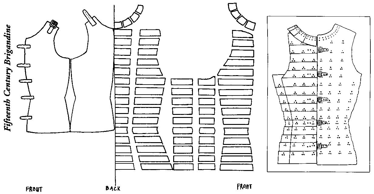

Classifying different types of armour depends entirely upon the agreed definitions of such armours. Scale is usually defined as small plates attached to some sort of backing in horizontal rows. The plates can either be aligned vertically or staggered and they can overlap in either direction but downwards is most common. Lamellar is defined as small plates laced or wired together in such a fashion that a backing material is not needed to maintain structural integrity. Some simplify this to say that if it has a backing then it isn't lamellar. Based on these definitions the Greek linothorax was reinforced with scale not lamellar. In fact I can't find a single example of true lamellar in Europe or the Near East dating before around the 3rd century AD. All earlier examples of so-called lamellar have turned out to be "locking scale" - i.e. scale armour that is reinforced by lacing or wire joining neighbouring plates together. There are examples of true lamellar in China before this time however. The earliest extant example dates to the Warring States period and consists of twelve suits of lacquered lamellar found in a tomb at Suixian. I don't know when true lamellar first appears on the Central Asian Steppes but would guess that it was around the same time or even a little earlier than the Chinese stuff.
Regarding brigandine. It does not have an inner liner. It consists of a foundation garment to which the plates are attached and a cover over the top (often of expensive material). The bare plates rest against whatever arming doublet was worn underneath. Brigandines were tailored to fit the contours of the body while the COP shows little evidence of tailoring.

PostPosted: Wed 08 Dec, 2004 4:21 pm    Post subject:         Reply with quote
That brig pattern is one of those I am most familiar with; I've seen the pattern before and I've seen some reproductions made based off of it. It's the curves and organic shape of the piece pictured from the met that intrigue me. The pattern makes a very nice harness, don't get me wrong, but there's just something that feels a little off about it. . . even the pics of the pieces Nathan posted seem to have more of an angular look to them.
Part of what bothers me about the patterned piece is that the skirt is too full and pronounced, and the fastening system seems out of place. If I had to speculate, it makes me think that someone involved in SCA took a coat of plates design, added conventions for use in sport combat, and extrapolated what such a piece would be like freshened up for the 15th century.
Just my thoughts; I may very well be wrong.

PostPosted: Wed 08 Dec, 2004 5:43 pm    Post subject:         Reply with quote
I had always been led to believe that it did, but as the above pictures bear out that this is untrue, I stand corrected. I see no reason while either a coat of plates or a brigandine could not have a liner, but they clearly did not have to. I am sorry for the unintentional misinformation.
That is a valid point, as coats of plates are often described as being "poncho-like" garments. That seems like a somewhat arbitrary distinction, but then so does size of plates, and presence or absence of a liner. Does anybody have information on the historical use of the terms "brigandine" and "coat of plates?" I know that coat of plates (sometimes called a "pair of plates") was used during the 14th century, and I think that brigandine was a contemparary term, but I don't remember for certain. It might make a difference. I will check the books I have here, but I doubt it will be in there.

PostPosted: Wed 08 Dec, 2004 5:56 pm    Post subject:         Reply with quote
If you put an inner liner on a brigandine, the action of the plates will tear it out very quickly.
The term is not a modern one. It was used in contemporary inventories and manorial records. Other variants include brygandine, brygandyne, bregander, bregandere, brigandyron, brigantayle.

PostPosted: Wed 08 Dec, 2004 6:03 pm    Post subject:         Reply with quote
I don't mind admitting that you are right, but what does bother me is that I have to admit first, that I was wrong, and second, that I had not even thought of that rather relevant aspect of armour construction. The really sad part is that I thought of it when I built my coat of plates, but just never managed to make the mental shift of applying it to something other than that specific project.
Thanks for keeping me in check, Dan.
