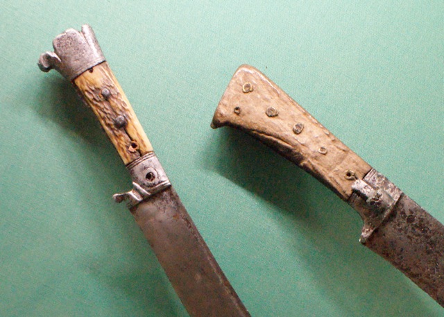

Tubular rivets and sometimes "spacers" were commonly made of copper or copper alloy on baurenwehr and messers. Below is an example of two knives from the 16th century. One has tubular rivets by a yellow-ish metal: a brass / bronze alloy of some kind. The other has tubular rivets of copper with domed iron nails inserted for a two color effect. One of the iron nails has fallen out, clearly showing the construction.
I cannot remember seeing copper alloy being used for guard and pommel cap: these would be made of iron/steel as a norm. This may be since the man/men who forged blade and hilt were not the same who put scales on the tang and finished the knife. The cutler may not have worked with hot metal, only doing cold work with sheet metal and filing/fitting forged parts to finished blades.
The use of materials in different parts of knives and swords may reflect the specialization of the craftsmen rather than, or as much as any material cost involved.

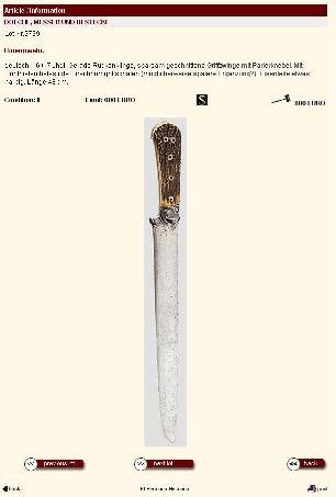

I went through gallery on this site, and found this messer: http://www.myArmoury.com/albums/displayimage.php?pos=-2104
unfortunately it provides no details (except that the source is Hermann Historica), but its guard seems to be from some yellowish metal. Maybe an example of copper alloy? I will have to try to find it at Hermann Historica...
Anyhow, it looks like a super-exception, plus it´s a different type than the one I took as an inspiration, so I´m still sticking with steel. I have already started to work on the blade, will post it later as a DIY project.
