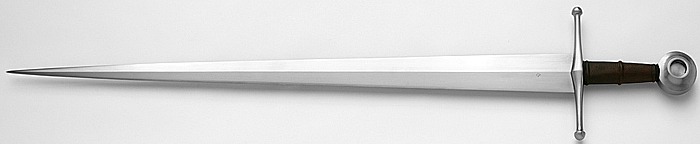

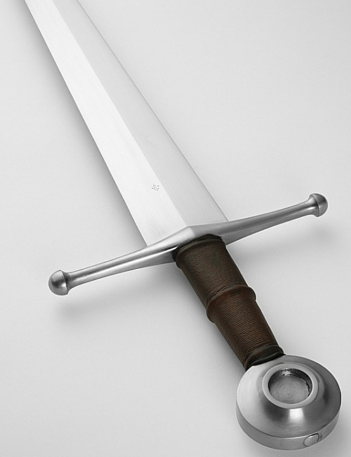

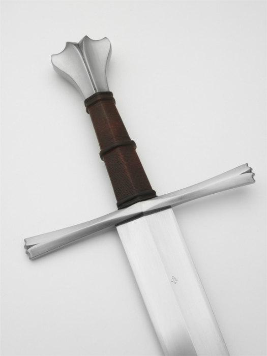

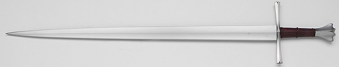

Photo From Albion Europe
Photo from Albion Europe
