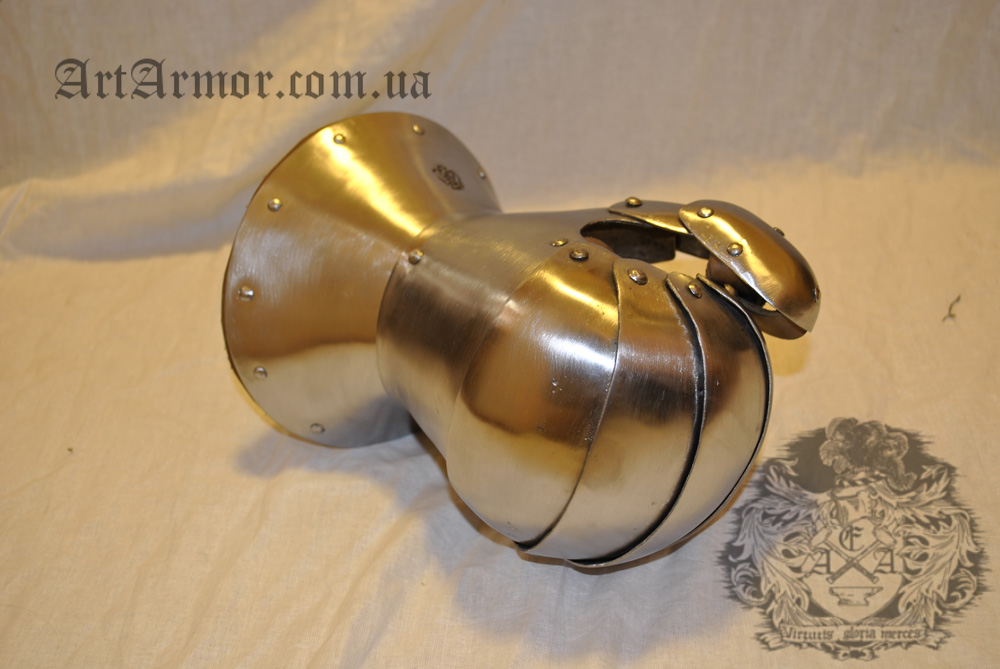

Also consider lobstered gauntlets rather than fingered, you can still go with the hourglass, but lobster grips are safer for the fingers due to there being no risk of applying too much preasure on an individual joint.

Regarding gauntlets I was planning on ordering something like the picture included in my post. Are they from much later? I really don't want to use fingered gauntlets..

As for the gauntlets, I'd definitely go for hourglass mittens rather than hourglass fingers.

Gauntlets: Mittens were introduced later in the 15th century. I think in the 1430ies? But good fingered gauntlets work really well, I have fought exclusively in them and never had an injury. But they need to be really good. You get them from well established Polish makers in hardened steel for at least 350 euro. Mild steel ones that are not heat treated work also well but are heavier as they need to be made out of 1,5mm sheet. They cost around 200 euro.. If you use a polearm, you can always point little steel disks to your fingers, we call them "fingershields". They have a 10 cm radius and cover the fingers really well.
