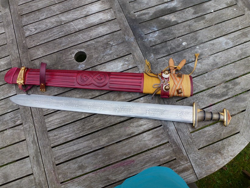

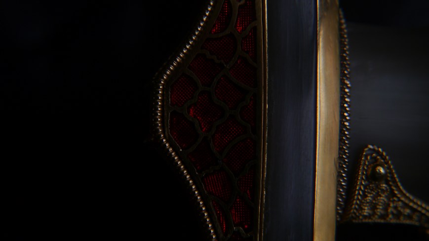

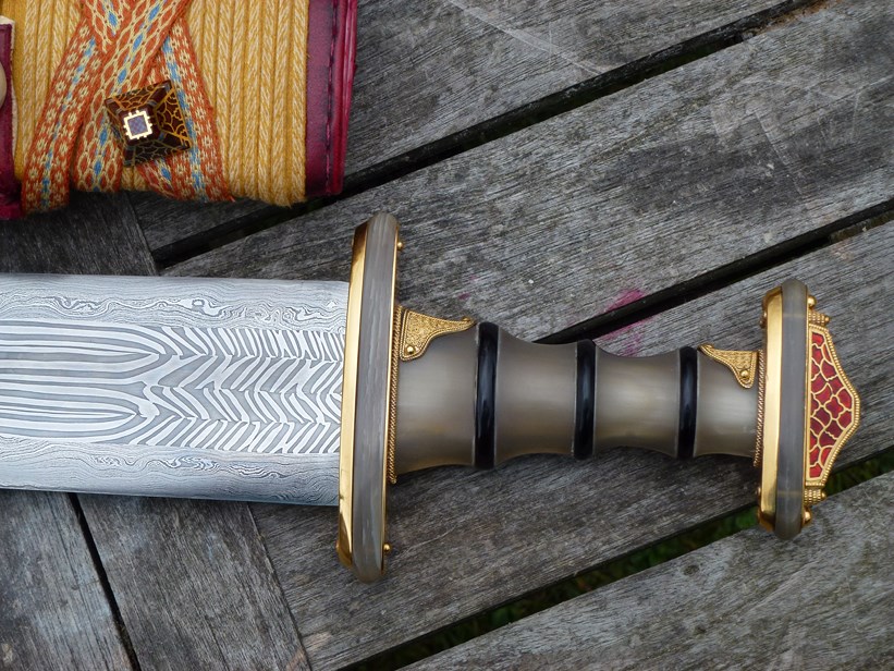

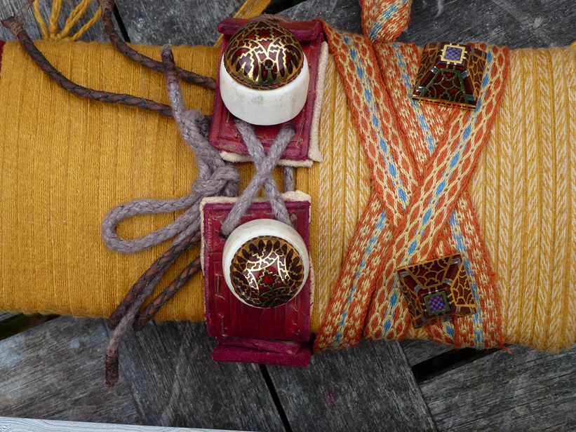

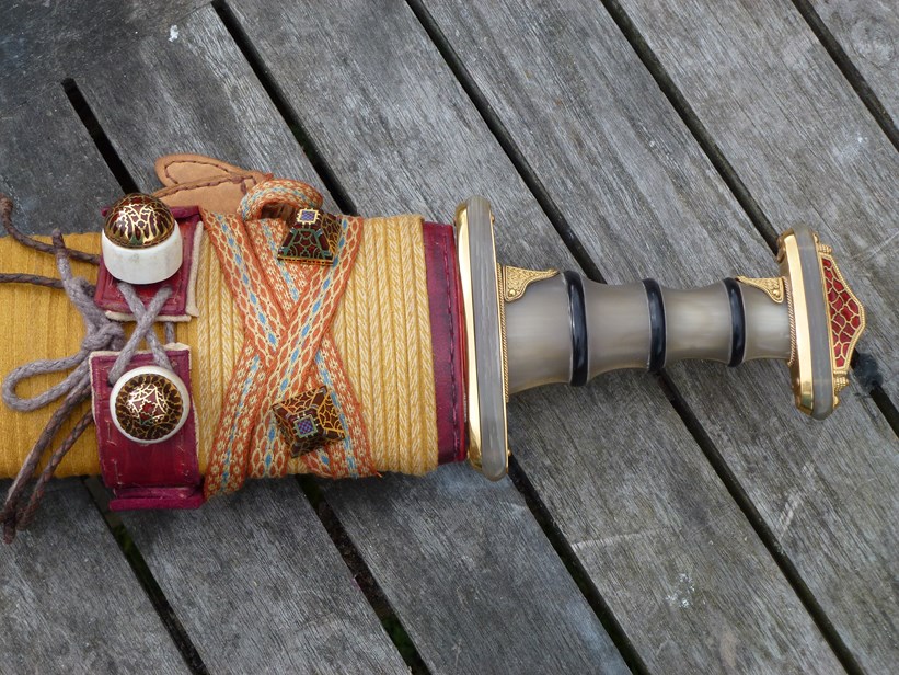

Here are a few pictures of my new Sutton Hoo Mound 1 sword.

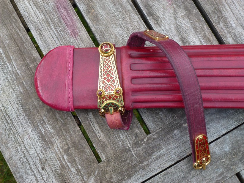

The blade is by Vince Evans, the grip by Dave Roper. Matt Bunker made the scabbard -- I asked him to make me something big and bold. The braid (apart from those attaching the pyramids) was made by Dariusz Wiewiorka and is based on the original - 6mm wide hand woven linen. We have used two different patterns of braid to add interest.

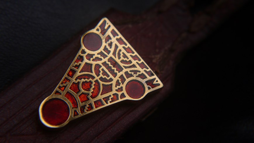

I have had to alter the sword belt and suspension slightly too as we have added he remaining jewels from Mound 1. Three of these have been added to the lower suspension strap. With everything I have tried to stick to the evidence - hence only two gold clips on the grip. All the garnets have cross hatched foils behind them - but these are so small they are difficult to see in the pictures.

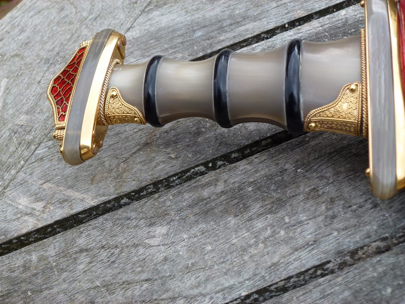

The grip is made from two types of horn - the lighter material is translucent.

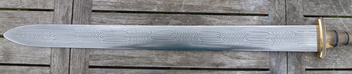

Here are some pictures of the blade, the underside of the hilt and a little wolf jewel that probably was used as a counterplate to the sword belt buckle. The two wolf's heads are very tiny.

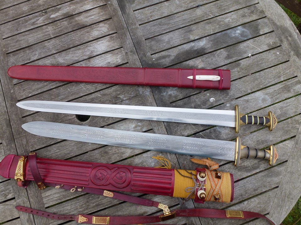

...and here is something you don't see everyday: two Sutton Hoo swords - the new one and my Patrick Barta.

Looks great! I particularly like the organic material used for the grip and upper and lower guard. What is it?
Also, I see you decided to use only two of the little plates/bits (not sure what they are called) on the grip. I know this is what is found on the real sword. Compared to your Barta sword, does it affect the feel of the grip in hand at all?

Hi Robin,
Thanks Robin. The number of grips doesn't make any discernible difference to the feel of the sword.
The grip material and the sandwich filling on the upper and lower guards are all horn. The white material behind the two sword bosses are deer antler.

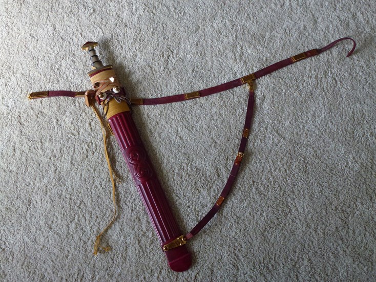

Here is a picture of the complete rig.

I forgot to mention that my sword doesn't have a fuller. Vince Evans and I were given access to the original sword out of its case in the backrooms of the British Museum and we could not find any indications that the blade ever had one, hence the lack on mine.
Although there are four bars per side there are some differences in the way that this blade has been constructed when compared to all other replicas of this sword. This was because Vince was able to get a good look at the x-rays of the original and recognised that it was probably made in a different way to what has been assumed up until now. I may ask him to explain.

I couldnt help noticing that the grip now has 4 concaved sections as opposed to your other one.
Which makes sense, you only having four fingers on your right hand.
I had never noticed the space for an extra digit on your PB version
I also notice the suspension 'buckle' is lower down. But i understand your reasons as mentioned above.

On a artistic note: I really like the contrast between the two types of horn. Which types are they?

Kai, with reference to the scabbard, the remains adhere to the corrosion products of the blade and are degraded to such an extent that no surface decoration or features are to be seen. It was definitely of wood and lined with skin from a long haired animal (as is the new scabbard). No leather covering remains, and it must be admitted, there may not have been one - however, it would be unusual if there weren't. The binding tapes still exist and the extent of the wrap can be worked out - starts at about 16 cms down from the throat - winds its way up and the rewinds back down to around 8 - 9 cms. We have illustrated that by using two different 6mm wide braid. No colours can be determined from the original.
There is a strange trough-shaped piece of wood that was laying along the top of the scabbard from the throat and between the bosses - it is around 10 cms long (I will look it up if anyone wants further details). I used to think it was a scabbard slide -- and that was why my earlier reconstruction had one -but it can't be - it was lying on top of the binding. It could be a sliver of wood that survives from the roof collapse that just happened to end up where it did or something that was laid on top of the sword after its deposition. Anyway, we haven't incorporated it because we have no idea what it is or why it was there. It has been removed from the original by the way.

Wow Eek! It simply dwarfs the earlier version from Barta
That is an absolute beast of a blade Big Grin Vince and everyone else involved in this project have absolutely outdone themselves. Bravo!!!

Some measurements:
length of blade:72 cms
length of hilt: 13.8 cms
width of blade below lower guard: 6 cms
width of blade 10 cms above tip: 5cms
thickness of blade below lower guard: 0.5
thickness of blade 10 cms above tip: 0.4 cms
overall length:85.8 cms
weight: 2 lbs 14 oz = 1.3 kgs
It is quite a heavy sword.
Both Vince and Dave were careful to try and match the measurements of the original, where these can be clearly ascertained. The hilt length is a bit of a guess and slightly (+0.4 cms) longer than that givenat in the published report.
