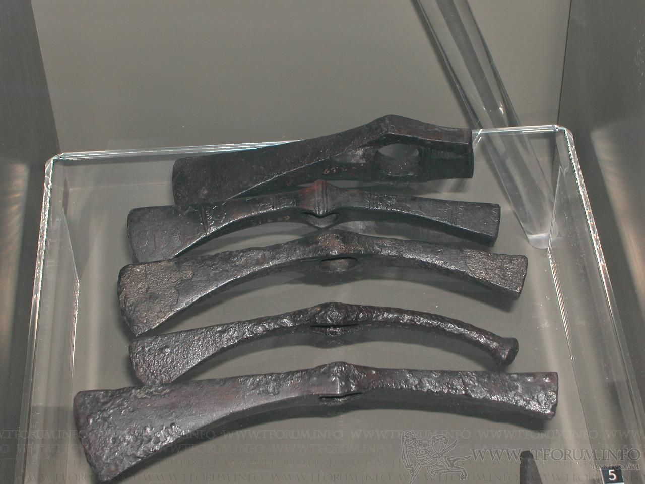

Scott, I recently saw this thread on Bladesmiths forum: http://forums.dfoggknives.com/index.php?showtopic=25866 Bogdan Popov has apparently done some considerable research into the Rus/Baltic type axes with round eyes and lugs on the back, and concludes that almost no grinding and no welding whatsoever was involved in their construction, just forged to shape and sharpened. Other than the Oseberg axes, I have not been able to find pics of examples well-preserved enough to give a good idea of the finish either.
Maybe a bit off-topic, Scott, but perhaps you will find these pics of pretty well-preserved axes with parts of the hafts intact interesting. The axes are from Krefeld-Gellup. I am not sure where I found these pics at the moment.
 Attachment: 203.43 KB
 Attachment: 163.13 KB

Thank you Scott for showing those. I can never get enough of that!
