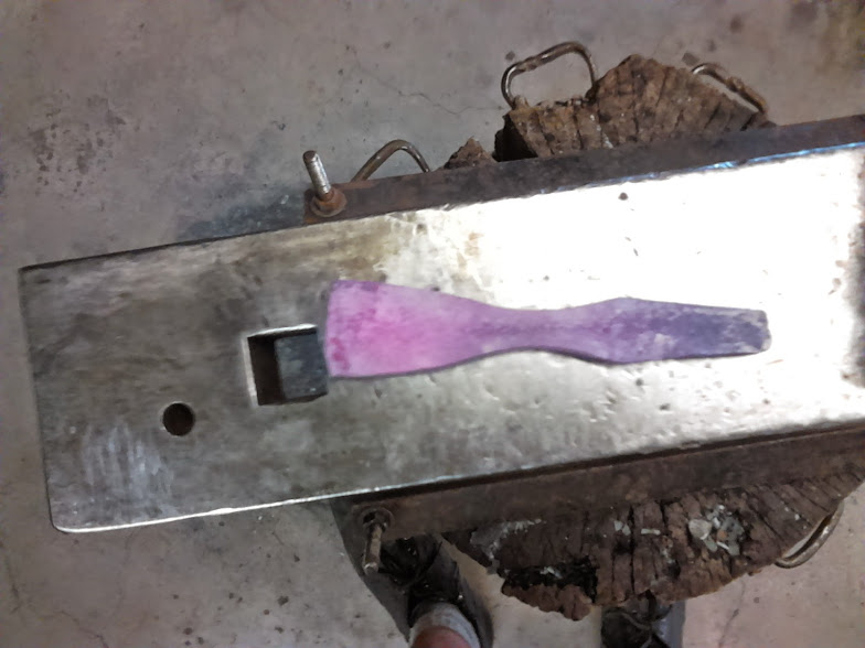

This is my 4th attempt at forging a spear head. Hopefully it will be my third successful one. Wink I'm not working from any specific historic reference for two reasons: First, I just decided to give this a go in class today, and I didn't have any reference material with me. Second, I haven't been able to find much reference material, especially in terms of dimensions and weight. If anyone wants to point me towards any info or photos of extend spear head from medieval europe, I would much appreciate it.
I started with a chunk of leaf spring cut out with a torch. Not the best starting shape, but it should work. I don't have a picture of my starting material, but here it is after a fair few heats. The general form starts to emerge.
Once I got the cone for the socket large enough for my intended shaft diameter, I started to curl it. I just made up a shaft diameter of 7/8".
At this point I had to run off to work. I should likely get the rough forging done tomorrow, no problem.
Any advice would be much appreciated. Blade making in general is fairly new territory for me.

It looks pretty good so far to me.
I'm of the belief that there is no one "right" way to do anything in smithing. There are plenty of approaches that will yield the same result, although with various degrees of efficiency.
My only advice on this would be to get the head closer to completely shaped before doing any more work on the socket, but then again, that's merely how I'd do it - to avoid messing up any work I'd done on the socket. Will you be welding the edges?

My only thought is that the initial blank might not be waisted in the middle like that. David Sim did some Roman spearheads for his book "Iron for the Eagles", and found that just starting with an isosceles triangle resulted in the desired finished shape. Though obviously that may depend on the exact type. Unfortunately, line drawings and photos of artifacts never give *quite* enough information...

Tim, in retrospect I could have worked the head a bit more before doing the socket, but in its finished state I think it would be a bit more of a pain to hold onto while doing the socket. I did end up finishing the socket first before doing the head, but it wasn't a problem. I just didn't let too much heat get into the neck/socket and worked the head carefully.
I'm not sure what you mean by weld the edges. You mean weld on the edges of the blade, or weld shut the socket? I hadn't planned to do any welding, really. The steel should have enough carbon to hold a decent edge, and I don't think historical spear heads had their sockets welded shut. At least not these few anglo-saxon spear heads I have some pictures of. Definitely something I would like to know more about though.
Interesting idea Matthew. I can't quite imagine how that would work though. Maybe the process of rolling the socket would impart the waist shape?
