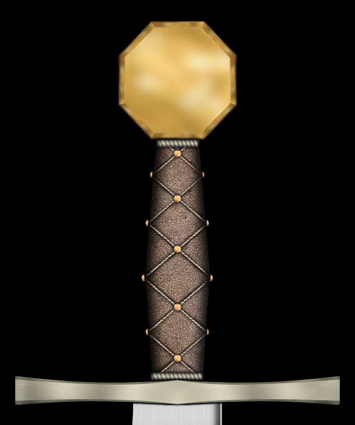

Greetings. I'll make a medieval falchion and I'm thinking of wrapping the grip with sharkskin, crossing over twisted silver wire and small brass tacks at wire intersections. Could someone tell me if this would be historically grounded? Could Medieval Falchions have grips that way? Thank you.

I've heard of this being done in East Asian weapons, but not in European weapons from that period. Personally, I hope someone turns up a European example, because that would be really cool!

I see Luke. Thank you for telling me this. I appreciate any information i can get on Falchions. But i know of some medieval european swords having grips like this. I am posting an image i made on Photoshop that illustrate the grip. Hope that helps. Regards.

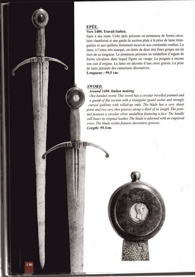

Oh, I'm sorry Phil. I meant the overall decoration of the grip, with the interlaced silver wire and brass tacks. Grips bound with shark skin i do not know. But i have a book with a picture of an european medieval sword with a ray skin grip. The same ray skin used on katana swords. I believe the sword could be ceremonial or something like that. But i think grip materials were a question of personal choice. I really believe a fighting sword could have had a ray or shark skin grip. As the alleged sword of King Edward III, has a hilt wrapped in adder skin. I hope i can get any bit of historical background about shark skin use. The alleged sabre of Charlemagne has a ray skin grip (the skin is under the ferrules), yet some say the sabre is not entirely european! People often confuses the ray skin used on those grips with shark skin, but it is definitely ray skin.

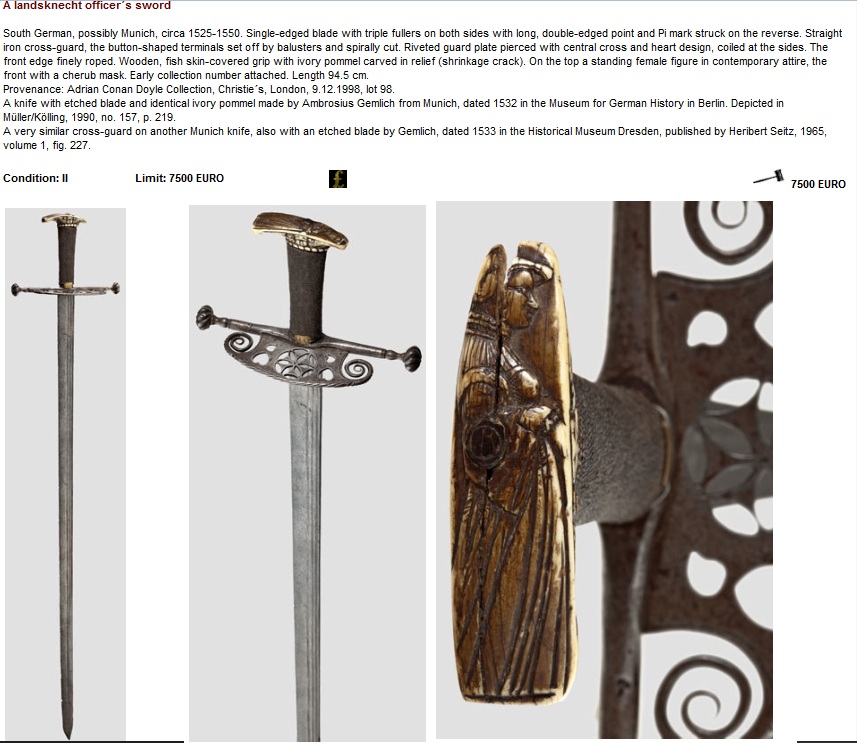

Well, this one (from hermann historica) is from much later period, has grip covered by fish skin (at least that´s what the description says), so it´s probably not so relevant for your original question - but still it´s a beauty Happy
Nice! Very interesting sword. Beautiful indeed. It is relevant in a sense that it has an unusual combination of organic materials. Fish skin and ivory. I wonder what kind of fish skin is that... Happy

Hello, here is other one from Hermann Historica dated 1480.

WOW Robert, Eek! This is precisely the sword in my book! The grip is ray skin.. Do you know from what auction it came from? Thank's for sharing.
