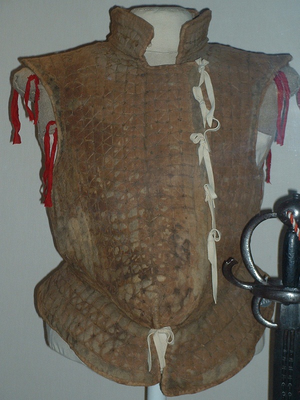

Hi,
i would like to know if someone can provide a full photo of the sword depicted near the jack of plates located at the royal armoury in leeds, or may be pointing me toward a website or link with some photos, or even show me other swords with a similar hilt arrangement (knuckle bow and one or two siderings)
thank you very much

Randall Moffett
Posted: Sat 15 Dec, 2012 4:27 pm Post subject: |
Sadly i just checked my RA folder and found I have 7 photos of the jack but none have a full sword shot. Sorry. It is a lovely sword from what I remember.
I just had grand schemes of making the jack but never got to it but have loads of photos for planning.

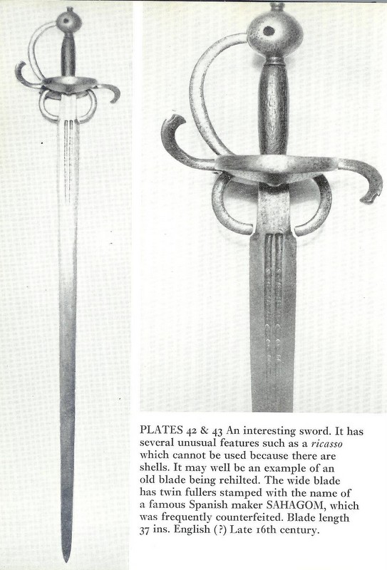

And here, thanks to Mr Erickson's hint, is the actual sword in the Royal Armouries. I have Wilkinson's book but didn't realise that it had a photo of the sword you wanted until he suggested it.

Radovan Geist
Posted: Mon 17 Dec, 2012 6:47 am Post subject: |
that sword depicted in Wilkinson´s book has an iinterestingconstructions. side-plates / shells ddefinitelydo not fit with the ricasso on the blade. Could it be a composite, as Wilkinson suggests?
I have seen couple of similar swords on Hermann Historica - they either have those side-rings and ricasso, and are considered as an early type of rapier (late 16th century), or have plates / shells, but no ricasso, and no lower rings, and are called riding swords / campaign swords (1620s-1630s).
Does the one in Leeds have those plates / shells?

E.B. Erickson
Posted: Tue 18 Dec, 2012 1:27 am Post subject: |
I think that the shells on the RA sword are later additions, because if you compare the RA sword with the excavated example, you'll note that the blades are virtually identical, yet the excavated sword doesn't have the shells, and doesn't have any indication that it ever had shells.
Given the similarity of the RA and the excavated sword, I have wondered if we're looking at a military sword "pattern". Pattern is in quotes because this is obviously way before anyone was designing swords dictated by government patterns. However, in England, those responsible for raising regiments would go to a specific cutler and have him make up a group of similar swords with which to arm the troops. Are these swords relics of a particular regiment?
While one can find essentially similar hilts from Europe, these hilts with the lack of lower rings and the "bite" out of the quillons are an English style. Interestingly, this quillon treatment is also seen on some English baskethilts of the 15-1600s, and the London Museum has a largish left hand dagger with these quillons as well ( I just remembered: I think that Claude Blair's book, "European and American Arms" has a photo of the dagger). The dagger also has a pommel shape that matches that of the sword that's the subject of this thread: was the dagger made to match a sword like this? Were they perhaps sold as a set?
Interesting questions!
--ElJay
