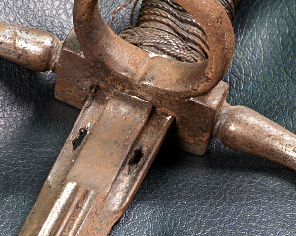

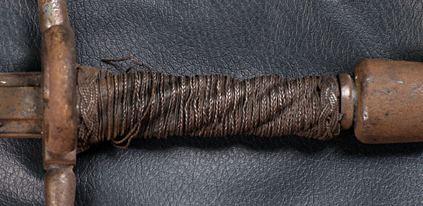

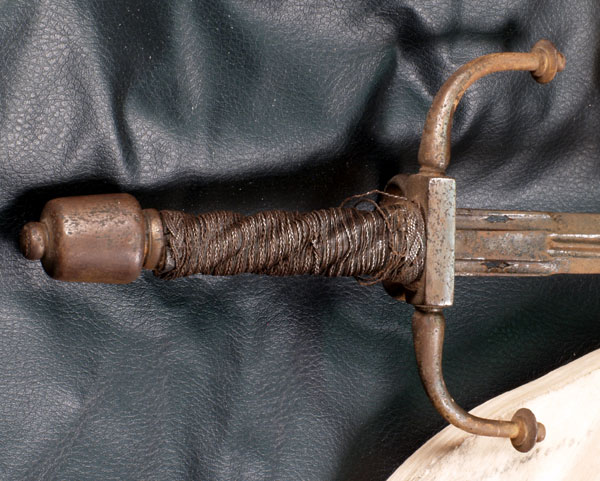

I'm about to put this up on ebay for the owner, but I thought I'd share the images here fwiw. Kinda cool to see something like this and play with it for a while. Serious piece of steel... And with all the discussions of modern reproductions it is always nice to look at what appears to be a mostly original old piece.
Left Handed Parrying Dagger, probably Italian (guess), also probably 1500's (another guess).
Overall length is 15-1/8"
Blade length is 10-3/4"
Width at base of blade is 19mm
Thickness at base is 5mm thickening out to 8mm then tapers to 6.5 at the end of the fullers near the tip.
Diamond cross section.
Ring diameter (exterior) is about 1-1/4"
The handle is wrapped in wire with some rather nice work. The handle has a sort of helix shaping which is remarkably comfortable in the hand.
I'll post photos in the next few posts as I finish working on them.

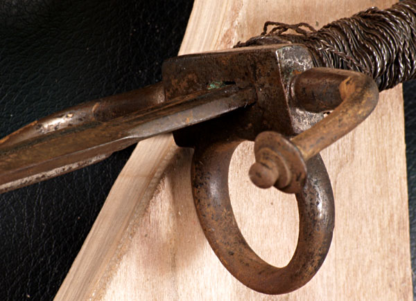

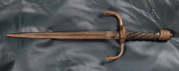

First bunch o' photos.
Attachment: 34.36 KB
Attachment: 123.37 KB

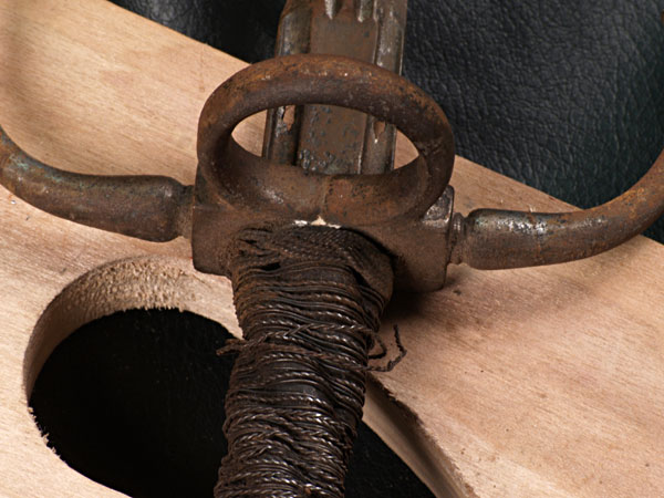

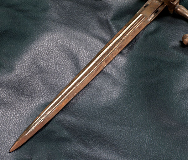

Next set
Attachment: 65.53 KB
Attachment: 99.93 KB
Attachment: 67.36 KB
Attachment: 68.91 KB

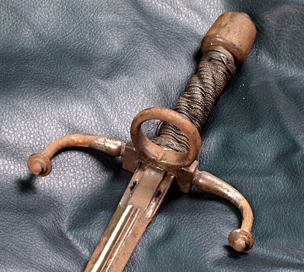

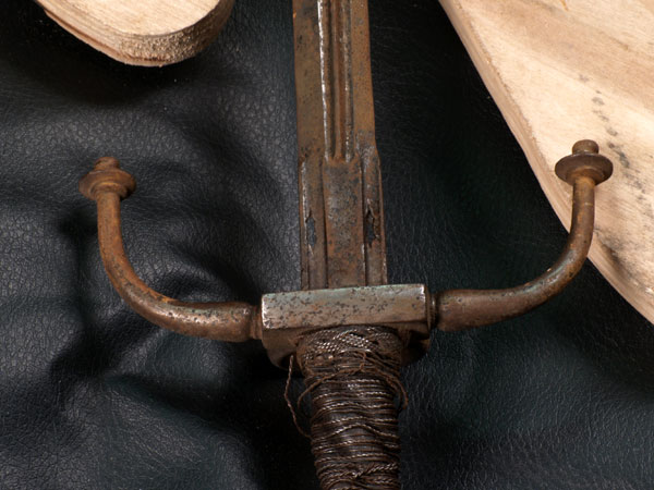

More...
Attachment: 63.14 KB
Attachment: 83.63 KB
Attachment: 98.14 KB
