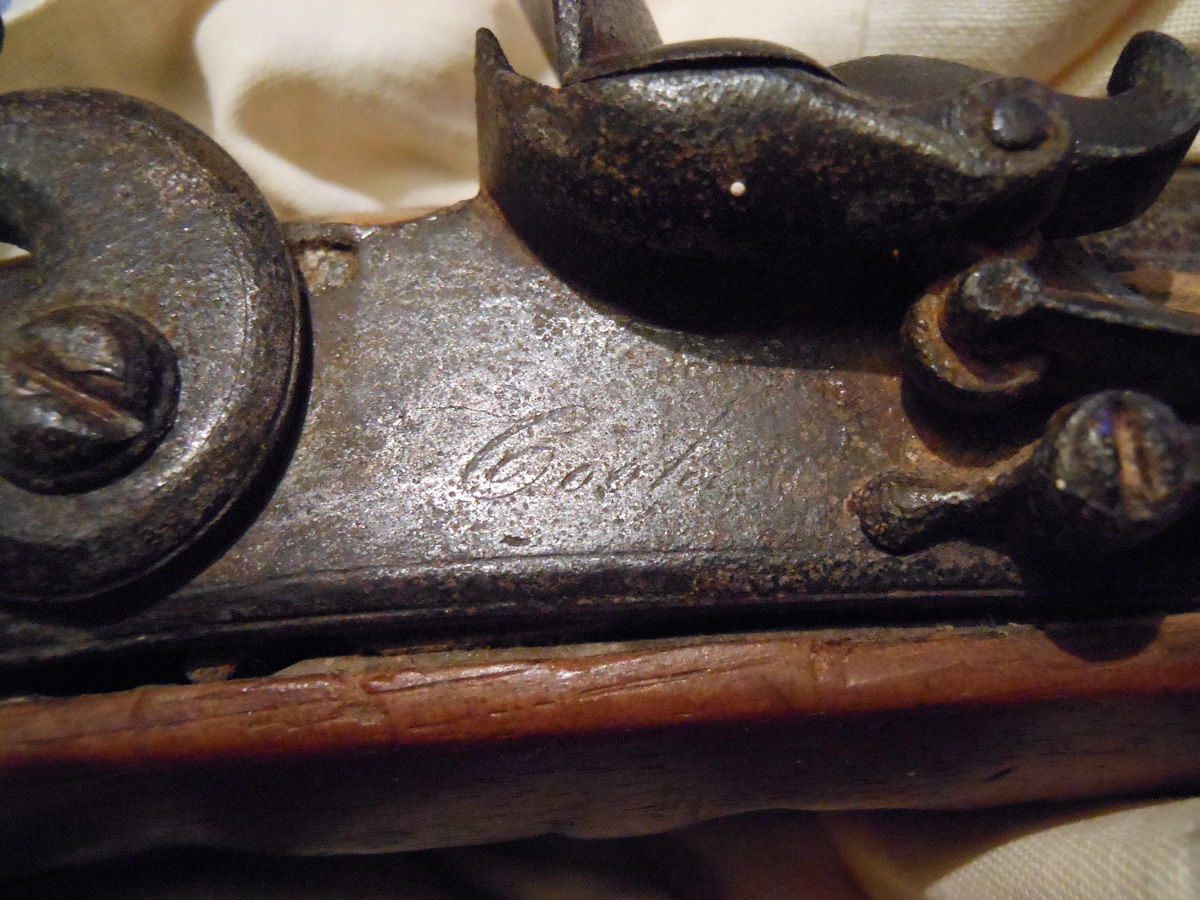

Afternoon folks,
I wonder if anyone can help me with identification of an old flintlock I have had in my family since I was a lad.
Unfortunately, I simply CANNOT make out the makers' mark, it appears to read Cobla / Coola / Coblo or replace the 'C' with a 'G'. It is most frustrating!
I have tried 'rubbing' to reveal it, photographing and zooming in, I even looked at it thru night vision infra red and played with the filters-all to no avail!
There are 2 separate marks of crossed spears, with a crown above on the left side of the barrel.
It is clearly not in good condition or valuable, but it would be nice if I can find out a little about it.
Does anyone remotely recognise any of the markings or stylisations which might reveal what it could be?

PostPosted: Wed 07 Nov, 2012 4:59 pm    Post subject:         Reply with quote
Thank you for that sir, I persevered- I have photoshop which is WAY too complicated, but i cracked it!
This is the photograph of the maker first, i shall resize some more of the rest of the pistol.
Incoming.......
Hi Ian,
the mark of a crown over crossed sceptres (not spears) is that of the Board of Ordnance at the Tower of London, or the Proof Mark of the Birmingham Proof House (they are very similar to each other). Without pictures I cannot help any further.

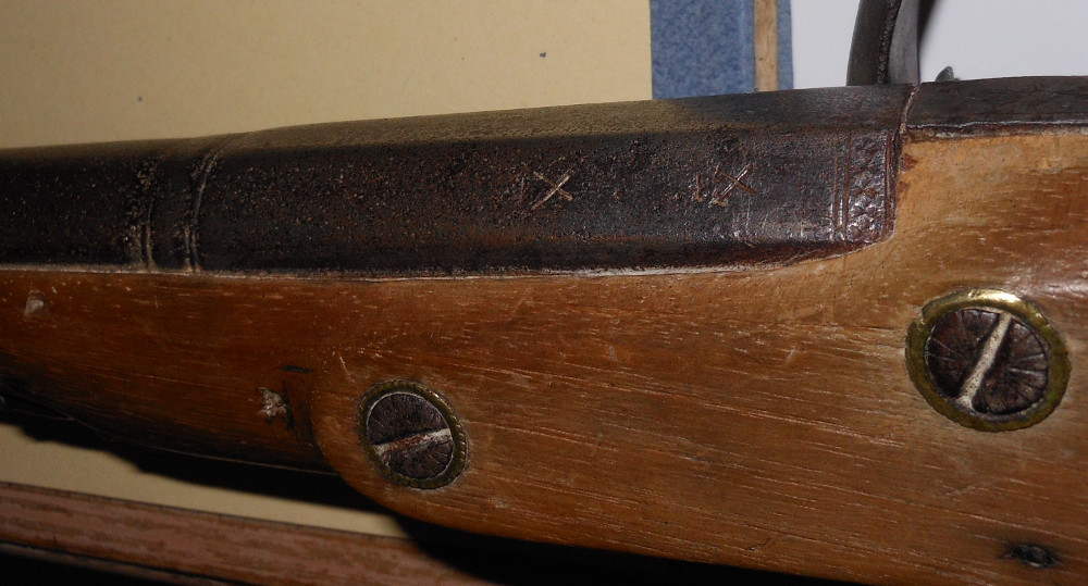

PostPosted: Wed 07 Nov, 2012 5:04 pm    Post subject:         Reply with quote
The crossed sceptres with crown......
 Attachment: 173.14 KB

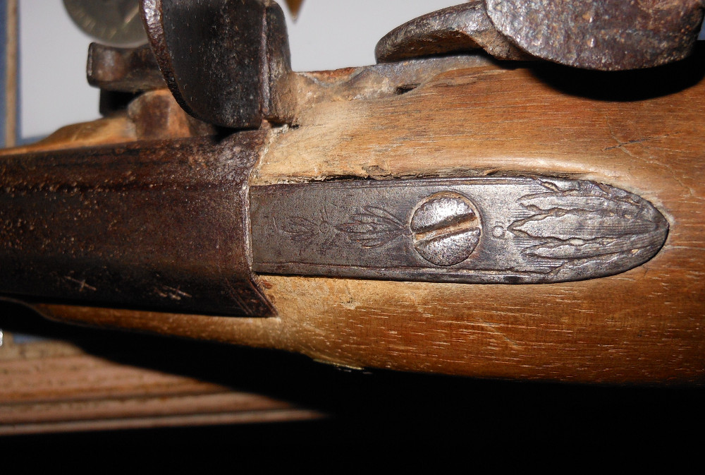

Ian Grant
Joined: 07 Nov 2012
Posts: 15
PostPosted: Wed 07 Nov, 2012 5:08 pm    Post subject:         Reply with quote
Some detail at the end of the barrel.....
 Attachment: 233.97 KB

PostPosted: Wed 07 Nov, 2012 7:32 pm    Post subject:         Reply with quote
OK...
It is hard to tell much from your photos but I will take a stab at it. It appears to be English, late 18th to early 19th c. The marks on the barrel are British Board of Ordnance proof marks. These marks were put on private gun makers' pieces which were proved at the official government proof houses at the Tower of London until 1797 when that function was moved to Birmingham. This service was available for any gun maker who paid the fee. The name, whatever it is, does not appear in any of my references but there were many, many makers of pistols in GB at the time and a lot of them made just a few guns before going out of business. The engraving on the barrel and tang indicates it was made for the civilian trade not the military. It is too bad that so much of it is missing although I doubt the missing parts would provide much assistance in identifying the gun.

PostPosted: Thu 08 Nov, 2012 4:18 am    Post subject:         Reply with quote
Yes, now we can see the marks and the whole pistol it is English, late 18th century from its form, proved at the BoA at the Tower of London. Somebody with access to the big dictionary of London gunmakers might be able to find a name to fit yours, but I can't find anyone similar at that time.

PostPosted: Sat 08 Dec, 2012 12:34 pm    Post subject:         Reply with quote
Looks like you have what was a nice quality pistol there..maybe not top of the range..but certainly not munitions grade either. If I recall..that roller on the frizzen spring was only used for quality work. I doubt it could be retored to great condition..but it's not beyond salvation either. I hope you can eventually track down the maker.

Stephane Rabier
Location: Brittany
Joined: 13 Nov 2006
Posts: 104
PostPosted: Mon 10 Dec, 2012 5:35 am    Post subject:         Reply with quote
Hi,
I read something like Cook, Cooler... but I don't know the British gunmakers well.
