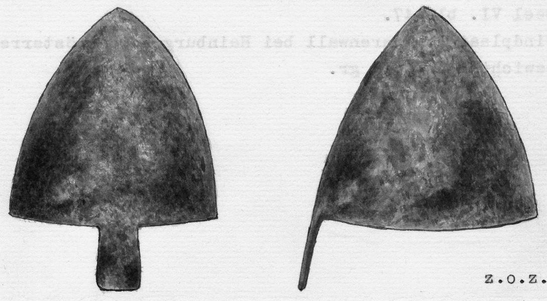

Posts: 669
PostPosted: Wed 02 Nov, 2011 7:59 pm    Post subject:         Reply with quote
Here's one that's housed in the Nederlands Legermuseum. It's providence is Hainburg, Lower Austria. 10th-11th century, I'd say. Very typical style. Cheers!
-Gregory
 Attachment: 104.9 KB
