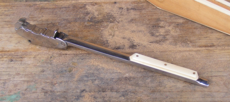

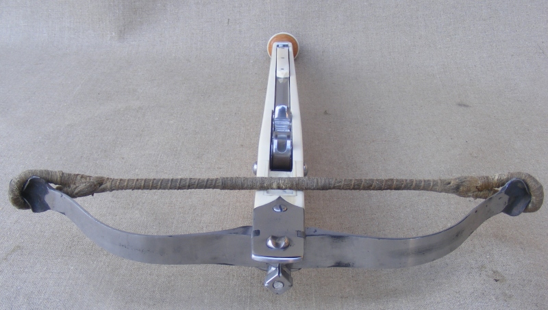

A while back, I set up a thread on making a Cinquedea and it was fun to have people watching as it came along and so I thought that it is time for another.

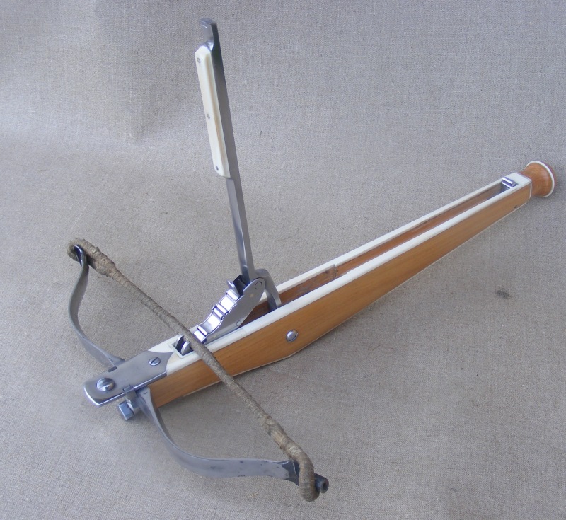

This time I am making a latchet bow and have added a picture of the last one I made. Latchets bows are small lever action bows with the cocking lever built into the top of the stock and a top mounted trigger. I actually don't know that much about these but I believe that they were civil defence bows from the second half of the 16thC and were popular in the North of England and in the Borders.
I examined one about 7 years ago and made a fairly close reproduction at the time and now making another and as these are rather unusual and interesting pieces I thought I would share the process.
The inbuilt lever and top trigger means that it can shoot about every 8 seconds and be shot single handed and although the draw is quite short with 225lb it will still pack a punch. The bow is about 40cm wide and has a triangular cross section and rolled ends.

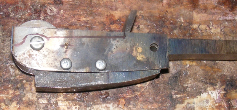

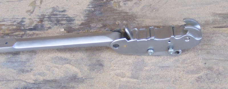

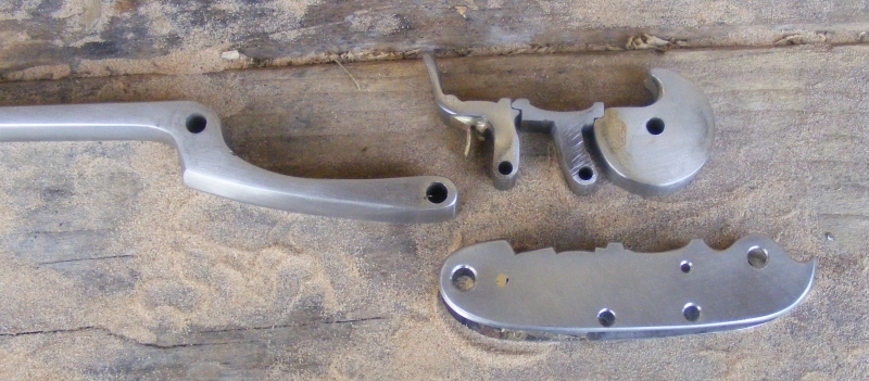

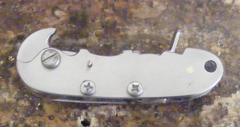

I started by making the nut and the sear train. I used a layout taken from an assasins bow which also uses a top trigger and I find a much easier system than the one fitted to this bow originally. The original system was very sensitive and it is tricky to get the balance right between hair trigger and impossibly hard, so I decided to use a different method.
When making a trigger the most common mistake is that the more load you put on the trigger, the stiffer it gets, so it in effect becomes self locking. This system doesn't suffer from this, but still has the great advantage of the more load you put through it, the more it locks, so it cannot slip, but crucially remains easy to trigger.

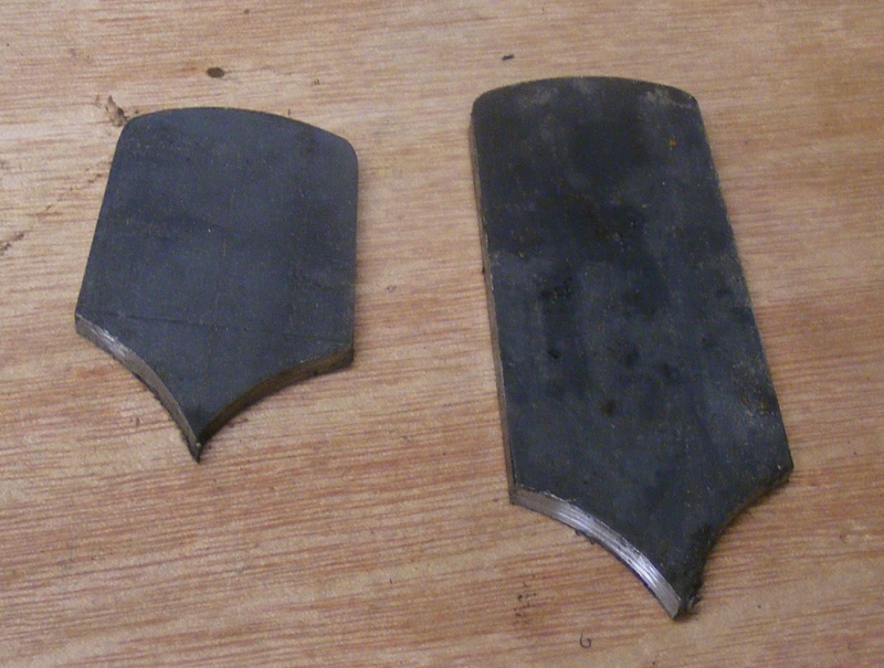

When the nut and sear train was made, I added roughed out side plates, drilled them and fitted them up to the roughed out lever. Once all the clearances worked and all the little interferences were dealt with, I brazed a spacer inbetween the plates and I polished the pieces up and started thinking about the string................

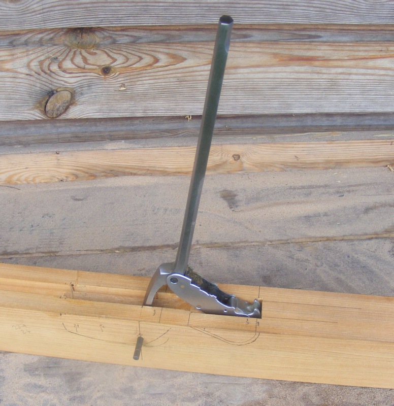

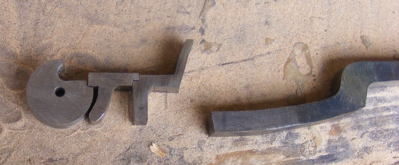

PostPosted: Tue 30 Oct, 2012 3:49 pm    Post subject:         Reply with quote

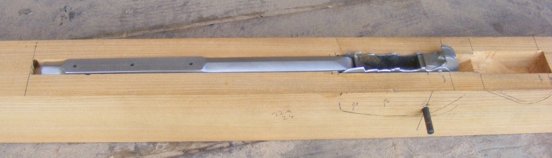

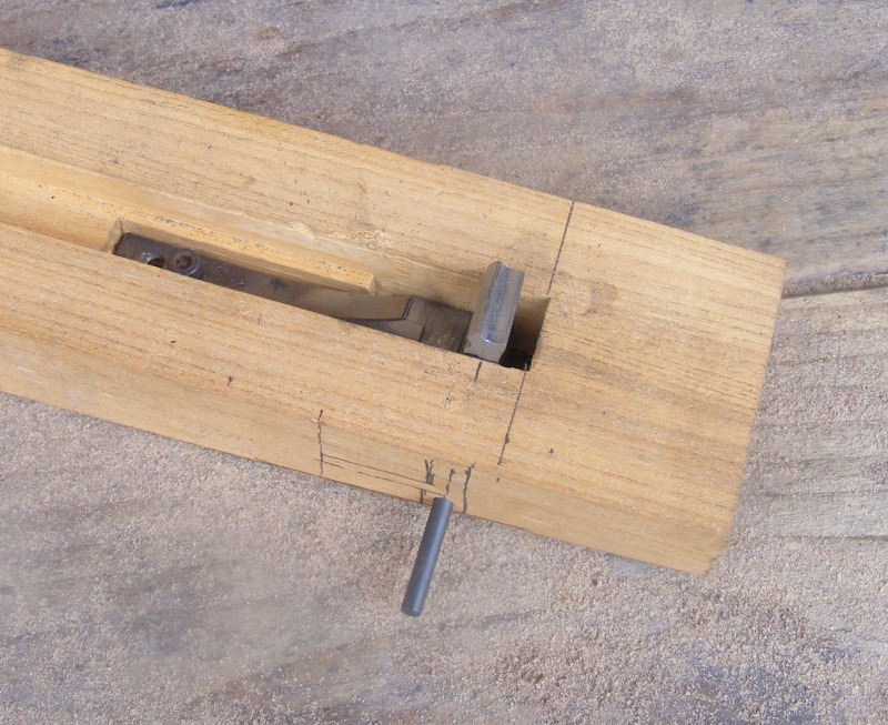

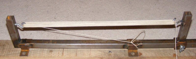

Thanks for the interest and hopefully this thread will make the process a bit easier.
Treat the steel like a spring and you will be fine, but find a spring steel available to you and heat treat it like a spring.
I finished off the cocking lever and trigger and got it ready to start sizing it up to the stock so that I could start cutting the recess for the lever and trigger. At this point it is not possible to set out the stock until the bow has a string because you have a given drawlength for the bow and until it is braced and you can measure form here you can't start.

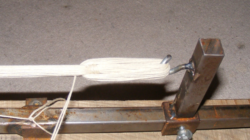

To begin the string, loop round a single thread until you have built up a bundle large enough - about the diameter of the bolt is usually a good rule of thumb. tie off each end and lay in the reinforcing loops and then put the spiral on the cord and then whip the ends and the centre.
I then wax the string, but as it can get a bit messy I will do this at the end after the bow is finished.

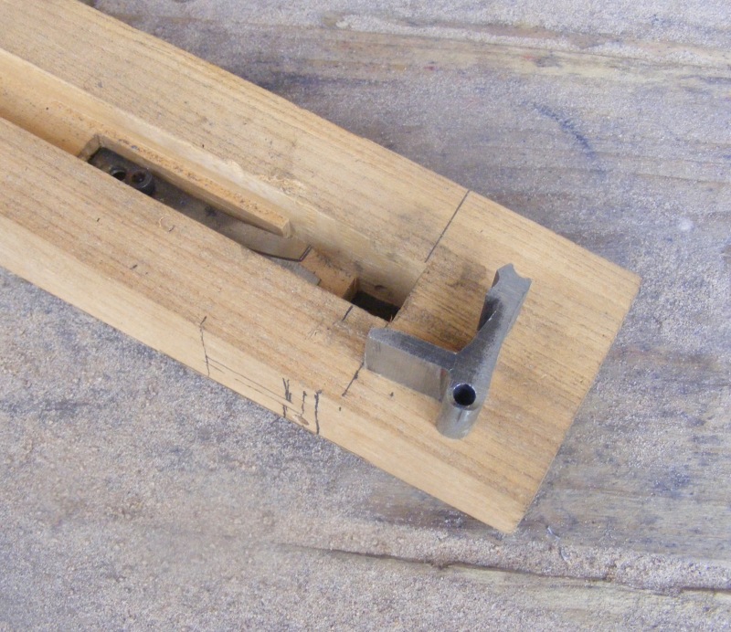

The next stage is to cut the angle on the front of the stock, estimating as best as possible what this should be to allow the string to just touch the top of the stock. If your guess is wrong asses how much it should be changed and try again. When this angle has been settled, the bow can be held in position and the brace position and draw position can be marked and then you can position the lever and start to cut it in.
When you lift the lever, the trigger slides forward and up and then dips down into a recess so the the nut teeth are just behind the string. This recess is then cut in and then lined with bone plates.

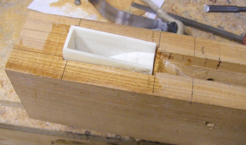

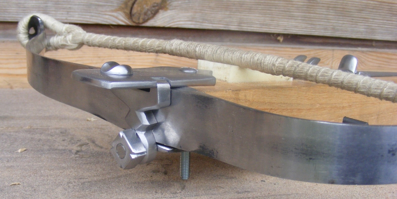

I started by fitting the lever and made sure that it goes through the loading cycle and went on to make the rear retaining catch. This is needed because when the lever is pushed back into the stock there is a reasonable force from the bow trying to pull the lever forward. This catch is very important to get right because if it fails at best the lever will fly forward and detsroy the stock, at worst, it will connect with part of the shooter on the way forward.
At this point, the stock needed shaping and the bow irons making and the bow mounted. I could now check that the whole system works together.
Now that all the parts are made the bone top and bottom deck can be started.

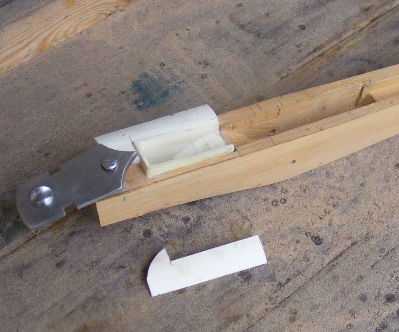

The top deck of bone was fitted on so that the panels were sanded to have a straight edge and these were glued to the stock to neatly line the edge of the cut out and when this had cured the bottom deck was applied.
The next stage was to turn the knob that is fixed to the butt. This feature is common to stone bows and small crossbows of the 16thC and aids whe you are spanning them as the butt of the bow lodges in the join of your thigh and trunk and so this makes it more comfortable. This was bonded on with a peg as a core and shaped to blend the lines.
The final stage was to flat all the bone off, test assemble the bow and lever and make sure again that everything works as it should and to get a level to use as a guide for fitting the bone scale to the back of the lever. The final stage is to fit this scale,
The scale is decoration, but also it has a slight undercut so that it provides a positive grip for your fingers. When you open the catch at the rear that holds the lever a spring pops the lever up, but the undercut allows you to get a good grip.

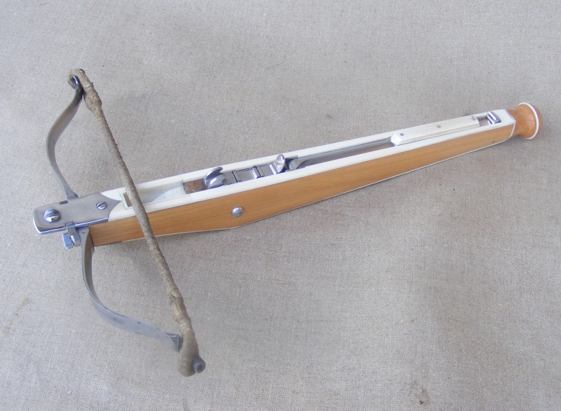

Thanks Robert, I am glad you are enjoying it. I know about the Arbalists Guild and infact lurk there from time to time, but as I have very wide interests in the medieval weapons area, I have found myArmoury to be fasciniating and invaluable to my development as a maker across many disciplines and types of object. I am not sure it is a 'brand loyalty' as such but I have very little time and between my facebook page, myArmoury and my work in general I have found that I really only have the time to devote to one site. I will make sure though that next time I post up an interesting bow I will alert you over there.

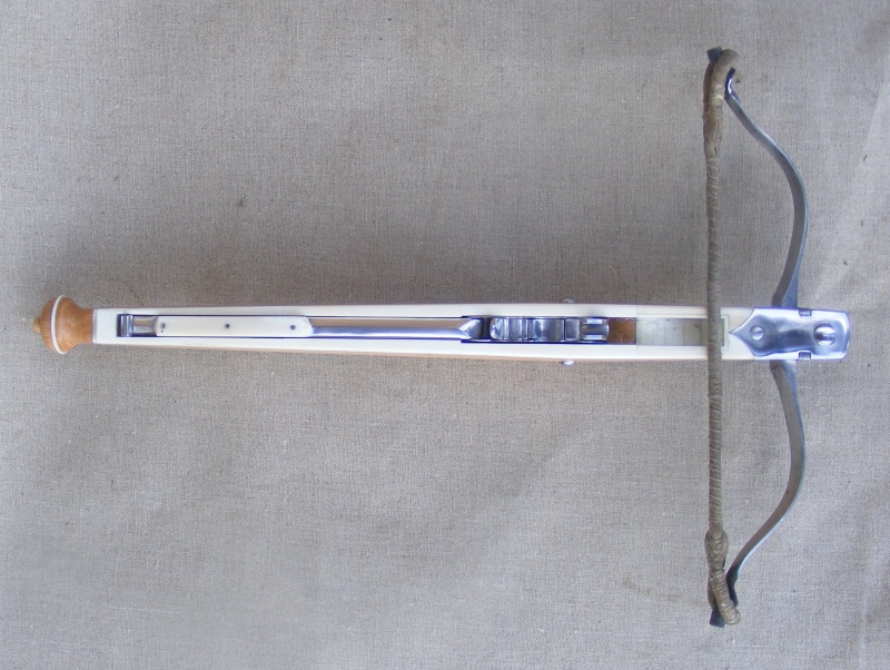

So after yesterday all that was left to do was make up a test bolt and shoot it. I have only shot half a dozen so far, enough to make sure that it is operating as it should. I had a request to post up some video on You Tube, so I will try and do that next week and then you will also get a scale of the bow with a person as well as how it operates and how quickly it shoots.
