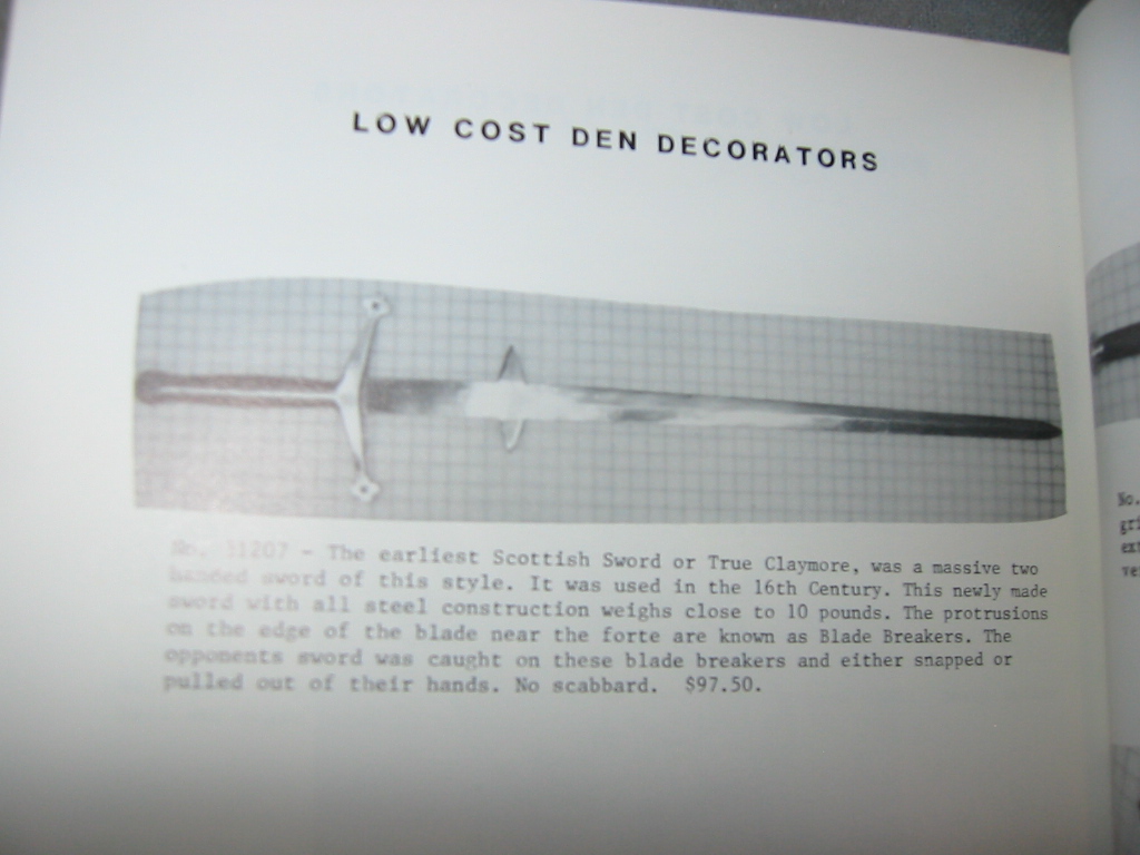

Glen A Cleeton
Location: Nipmuc USA
Posts: 1,979
PostPosted: Sun 21 Oct, 2012 12:40 pm    Post subject:         Reply with quote
Hi Dana
Your mention of a Florida Museum Of Weapons had my gears sinning a bit but the outfit I was remembering was a Museum Of Arms in Miami. Digging out that catalog to be sure, I also looked through the pages and found (a bad shot of) another odd bladed decorator. Probably just coincidence but a "go figure" moment anyway for two Florida collections with odd swords Wink
GC
 Attachment: 238.31 KB
