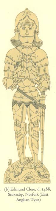

Edmund Clare, c. 1488. Simple pairs of lines

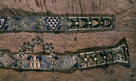

Phillip's mention of beadwork brought to mind the belt of Fernando de la Cerda. I suspect anyone viewing an effigy or sculpture showing such an item might jump to the erroneous conclusion that it was tooled leather. When we see an escutcheon depicted on an effigial scabbard, how can we say whether it is cut leather or an enamelled gilt plaque?
I suspect Chad's 2nd question will be difficult to answer. I expect that some scabbards were more expensive than some swords. "Was any given scabbard more expensive than the sword it was designed to sheath?" is perhaps a more refined way of asking it. I'm sure we can find two widely varying figures for the cost of a sword in the same year or decade, but the expense of the furniture on a blade for a king wouldn't really be comparable to a munitions sword. Certainly the cost of decoration of any piece of armor or weapon could exceed the value of the base piece itself, considering the application of gold, gems, pearls, or holy relics.

Okay. The following scabbard is one of the main bits of evidence I've seen of painted decoration. I've only ever seen the sketch drawn of it in the early 20th century, but it has an apt description:
"Scabbard with Strap 1160-1220... The scabbard fragment in figure A was made from wood, covered with parchment, and decorated. At its mouth is a piece of leather cut into a half circle, and partially covered with green and red silk."
J. H. Hefner-Alteneck, Medieval Arms and Armor - A Pictorial Archive, p. 9.
Following are images of two original thirteenth century scabbards emphasizing the lack of risers and showing details regarding the baldric setups, which have also become unusually typical among modern examples. There are a variety of suspension systems to choose from!
Sword of Fernando de la Cerda, c. 1275.

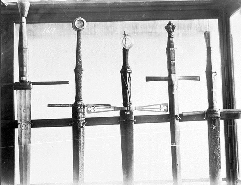

This image is unique and instructive because in the case of the red sword at left, the artist clearly distinguishes between the gold of the locket and the gold of the chappe. The locket has depth. The decoration of the chappe does not, which suggests to me that it's painted ("shell gold," which was in use at this time). Gold stamping is a slightly later innovation, so would not be appropriate here.
Notice, also, that although the subtle texture and decoration of the grip are rendered, the body of the scabbard is without mark. This reinforces the sense I get looking at these images that in the case of fine swords, the body of the scabbard was more often considered to be the ground for display of fine metalwork, as in the other images below. Black and red set off gold beautifully, and if you have all that master goldsmith work, why would you undermine with even masterful leather tooling?

Some examples of decoration on more common weapons, plus one not-at-all-common one. Note the apparent use of paint or fabric and tacks(?) on the chappe in the first image and the simple tooling of the chappe and scabbard in the second image.
If the last image is thought to have any basis in reality, it might depict a tooled and gold-painted scabbard, which would be an expensive decoration, for sure. Think about the most impressive gold-illuminated manuscripts. It would take a heap of shell gold to cover a scabbard.

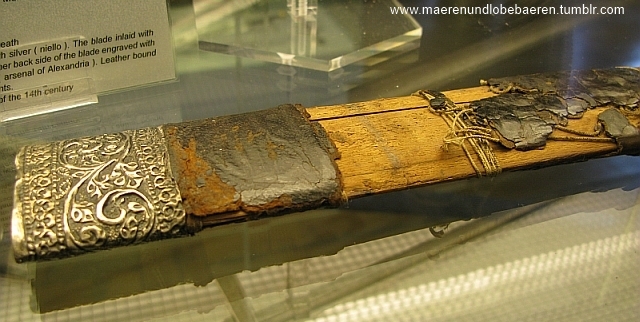

PostPosted: Fri 12 Oct, 2012 2:23 pm    Post subject:         Reply with quote
Hi Chad,
I am very pleased to see, that our little conversation about tooled scabbards has sparked your researchers spirit! I'd like to contribute the little evidence I have for less tooled scabbards. This scabbard is currently at display at the Rothenburger Reichsstadtmuseum. I unfortunately don't know it's origin and age for sure, but I guess the plaque maybe associated with it, so it would be from the 14th century. It supports Seans claim of highly ornamented metalfittings for that timeframe. More than that you can see it's inner setup: thin wooden core, several, broad risers made with loops of string and a thin leather covering, which lacks any tooling. The scabbards mouth is covered in very ornate silver metalwork.
From the 15th century we know depictions of very plain scabbards, lacking any decorum like leather tooling, beads or coloring other than the dye used for the leather covering.
Regards,
Thomas
 Attachment: 194.16 KB
Scabbard, probably 14th century.

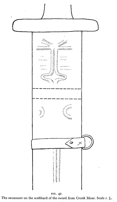

Risers were in use, atleast pre-1000.
The Cronk Moar Scabbard
 Attachment: 49.55 KB
