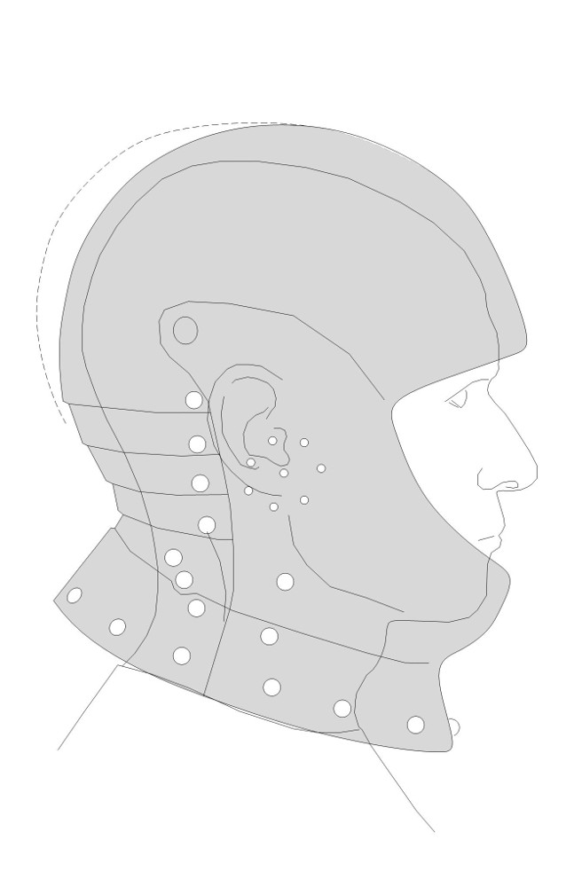

PostPosted: Wed 20 Jun, 2018 11:27 am    Post subject:         Reply with quote
I've scoured my library and not found any helmet quite like this. There are Italian casques of the early 16th century that have a similar articulations, but they invariably have a brim visor. The bevor portion of this helmet appears to match the skull in every detail so I don't know what to make of it.
I'd like to point out one more thing that troubles me about this helmet. The parietal portion of the skull is not very full. It suffers from what many modern reproductions do: the shape is too round, too blunt. I put together the attached image to describe what I mean. I used my head profile, and my head is rather elongated compared to some, but it serves the purpose of discussion. When I align and scale the helmet based on the face and neck openings, the skull shape is not well formed. I have made a few interpolations when tracing the photos, and the photos are not ideal for getting a flat projection. Still, the various views of the helmet make this whole helmet suspect to my eye. I added the dashed line where I feel the fullest part of the skull should be.
Without a stylistic comparison, it is hard to critique much further. I feel the chin is not well formed and the nape of the neck seems high. The latter is likely due to modifications of the lower collar lames. I'll keep my eye out for a comparison.
-Adair
