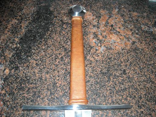

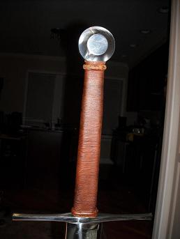

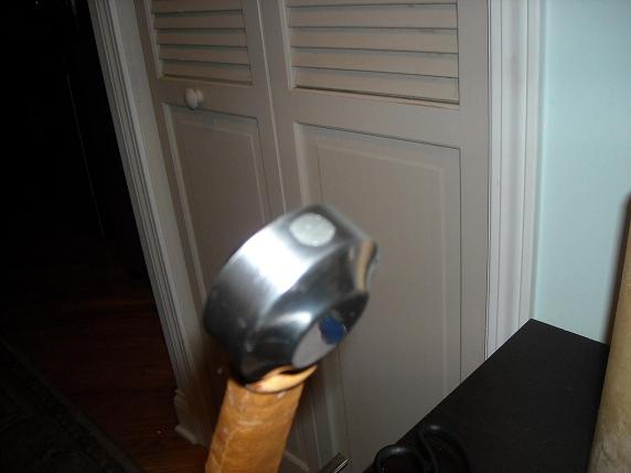

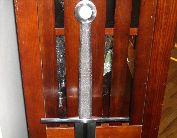

Yes the leather wedged between the guard also at the top of the grip by the pommel.When i took the old leather off there was light cord between the wood grip and leather ,the old leather I pulled it off with my fingers in a few seconds. The one photo is the new grip which I did myself it was my first time.The other one is the grip after I took off the old leather.Also after i did epoxy the grip to the tang I gave the pommel a hot penned look.

pommel

old grip

Finished
