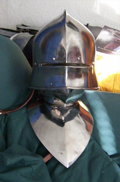

Digging up this old thread since it seems most appropriate to post this in. A friend of mine had a reproduction of this helmet made by swedish armourer Albert Collins and we went to pick it up just a few hours ago. So i though id share some pics i took of this wonderful gothic beauty.
 Attachment: 30.02 KB
 Attachment: 86.38 KB

PostPosted: Tue 18 Jul, 2006 10:45 am    Post subject:         Reply with quote
Supersnygg!
Albert is really good at what he does Happy I'm waiting for a dagger i irdered from him and have been thinking about ordering a Sallet and a pair of gauntlets from him:)

PostPosted: Fri 21 Jul, 2006 10:24 pm    Post subject:         Reply with quote
Interesting.
Do you know if the repro is raised in one piece of metal or if it is made of two parts welded together?

PostPosted: Sat 22 Jul, 2006 3:13 am    Post subject:         Reply with quote
Hi, Albert makes his pieces raised in one piece of metal:)
View user's profile Send private message Send e-mail MSN Messenger
W. Schütz
Location: Sweden
Joined: 19 Dec 2005
Posts: 369
PostPosted: Sat 22 Jul, 2006 3:51 am    Post subject:         Reply with quote
Albert Collins usually does helmets from one peice, but this one is actually not made that way. I think the waiting-time was a factor in ordering a two-peice helmet, since Albert is a busy man and making such a helmet from one peice would have taken far longer.
And about the "squiffy" lines mensioned earlier; i have to say that after seeing Albert Collins work up close he is truly a master of that authentic feel. His things have strong charachter and i think he really focuses on what armourers focused on back in the day.
