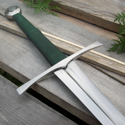

Here's the latest addition to the Elite Line: The Godwin.
Overall Length: 46 1/4"
Blade Length: 34 3/4
Blade Width at Guard: 2 1/16"
Blade Thickness at Guard: 0.23"
Handle Length: 9"
Guard Length: 9"
Pommel Length: 1 7/8"
Weight: 3 lbs. 1 oz.
Point of Balance: 2 3/4"
Point of Harmonics (Blade Node): 21 1/4"
Guard/Pommel Material: 1020 mild steel
Grip Construction: Ash Core, Cord Wrap, Leather Wrap
Scabbard/Sheath: Included Wood Core Leather Covered
Oakeshott Type: XVIIIa
Guard Type: Type 4
Pommel Type: Type J
Grip Shape: Tapered with dual mid ribs
Construction: Peened
Blade Steel: 5160
Price: $1,599.00
For inspiration I was thinking of the XVIa.5 from Oakeshott's ROMS, which is of course a type XVIa and I classify this as a type XVIIIa due to the sharp profile taper and 1/3 length fuller. For me at least the classification is a little fuzzy between these two types so I suppose it could fall under either category.
Comments and questions are welcome.
 Attachment: 81.53 KB
 Attachment: 71.36 KB
 Attachment: 67.96 KB
 Attachment: 83.67 KB
 Attachment: 67.53 KB

Since you gave us the blade thickness at the guard, could you also give us 2 more thickness measurements - at blade midpoint, and maybe an inch or so up from the point? This would give us some notion of what the distal taper is like.
Also, I was looking at your website, and am a little confused (that happens often to me) Some of your products are listed as "Handmade Windlass Sword" or "Handmade Hanwei Sword" - obviously products form those companies. Do you take, say a Windlass sword and then modify and improve it?

Roger: At 17" from the guard, the blade thickness measures 0.178" and at 1" from the point it is 0.095". I re-measured the thickness at the guard and it is 0.23" thick. I was in a rush when I initially measured it. Eek!
With regards to the Hanwei and Windlass products I offer them as they come from the factory but I have performed many upgrades on their base-line products over the years. For my lower priced swords I actually use the Hanwei/Tinker blades as a base and further refine the edge geometry and polish them and then the hilts are made entirely by me. It helps me to provide different price tiers, and give my body a break; I used to hand forge every blade in my normal line-up. Now the Elite Line, such as the Godwin Longsword here, are entirely hand forged by me personally.
I am willing to modify and upgrade virtually any Hanwei or Windlass product, but its a service I haven't widely publicized yet (not sure why not to be honest...).

Thank you for the kind words Brian. My goal with this sword was to create something appropriate for a 15th century English archer in the employ of the Burgundians or at Bosworth or Stoke. One of the common remarks from contemporary chroniclers is that in contrast to many continental European soldiers, the English tended to favor long swords. I am president of a historical society up here in northern Minnesota and one of my personas is a late 15th century English mercenary named William Godwin. I thought this type of sword would be an appropriate side-arm for such a man and named it accordingly.

I wanted this piece to feel ready for action, quick and nimble.
