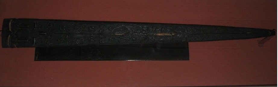

Question... I have been looking at cinquedea scabbards in paintings and pictures of origional ones...
What do you think... all leather or leather covering a wooden core? Vegetable tan leather for the origionals with all kinds of tooling. I suppose it would have to depend on the size of the cinquedea. The one I am making is the DelTin with the 18 inch blade. It has a bit of heft to it and I don't think just leather will do it well.

Base it on originals. Everybody who's guessed at cinquedea scabbards makes silly things, in my opinion. There are plenty of references available.
I would choose two layers of leather: a hardened leather (baked, perhaps) with a tooling leather on the outside. I would not use a wooden core, and certainly not a fully-formed one.
Attached are some that I've put on myArmoury.com before.

Second picture is the one I was looking at in detail from another post about wearing cinquedea... as it was the only one I have seen so far with both the front and back shown. Where do you think the seam is hidden?
Tooling leather and no wood core it is then.
I am thinking about 8 or 9 oz leather could work. Partially wet form the leather... then do some basic tooling (I am not the most gifted artist) and sew it all up. That little chape looks very doable.

Posted: Sat 21 Jul, 2012 12:34 pm Post subject: Original scabbards |
Dear Christopher,
From personal experience, I can tell you scabbards are definitely only one thickness of leather, semi-tanned (scabbard butts), of varying thickness, up to 3mm max. For full discussion of manufacturing technique of hardened leather see my article "As Tough as Old Boots?" about hardened leather armour techniques of manufacture. IAAConference proceedings 2003. No oven necessary.

Posted: Sat 21 Jul, 2012 1:40 pm Post subject: |
From the V&A in April 2007...
Attachment: 58.72 KB
Attachment: 75.65 KB
Chris Dobson
Posted: Sun 22 Jul, 2012 3:38 am Post subject: |
Precisely: cuir bouilli was made from semi-tanned leather, now sold as 'scabbard butts'.

Posted: Sat 28 Jul, 2012 11:39 am Post subject: |
Here is what I ended up doing... its about 5oz tooling leather, tooled dyed java brown and sealed with tankote. The attachment on the reverse is with a thong made of black dyed hemp twine waxed wth beeswax. The thread used to sew it all together is waxed linnen thread double needle harness stich
