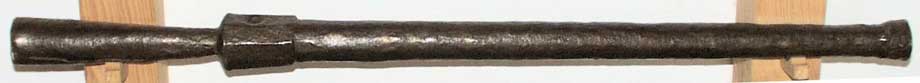

Over here in the UK, live-firing guns (even copies of historical guns) have to be locked away in steel cabinets, and can only really be handled by their owner.
So if, like me, you want to display them or have people handle them, you have to compromise.
For a recent 'show and tell' event and to hang on my wall, I've made myself a couple of medieval handgonnes. The 'barrels' are dummy (ie. turned hardwood with a steel liner for weight/strength), but other than that they are made as if real. Stocks are beech, and all the metalware is forged steel.
The long 'pole' handgonne is copied from an original artifact (see below) but I have slightly scaled it up to a 24" barrel (around 13mm bore). It is around four and a half feet long, and beautifully balanced (I will be getting a live-firing version of this made up, hopefully later in the year). I have also made a 'hot wire' to fire it, with a pear wood handle. It would date from around the turn of the 15thC.
The hackbut would date from the mid 15thC. As it's name implies (hakenbusche or hook gun), it has a fearsome steel spike, used as a recoil/steadying device, and also a weapon of last resort! It is a little over two and a half feet long, with a12" barrel (around 17mm bore) held by forged steel hoops. It sits nicely either on the shoulder (like a crossbow) or under the arm. I carved a serpent linstock for it, from oak.
I hope this shows others in the more restrictive nations out there that it is possible to make near-identical reproductions of these weapons without the associated law enforcement headaches.....

Hi
I want to have one of those for some time, for events of Late Middle Ages. I don't want it to shoot bullets, only to make noise. But in Spain is hard to find good reproductions and, also, it's need to have a firearm licence.
IMO, your idea of ​​making the barrels with turned hardwood is excellent. The result is magnificent. The details are very well kept and the blued is very realistic. It's like the work of a Luthier.
Congratulations.

hmm in reference to the hook guns spike beng a last ditch weapon,
wouldnt it be possible to use the other kind of handgonne, i.e the tube-on-top-of-a-pole, ones n a similar fashion
be be a fairly good mprovised cudgel, especially since some consst of a nearly 3 foot pole, and a 1 foot i wonder how much they weigh but beng hit in the face with a metal pole thats scalding hot from having just fired a few rounds, would be unpleasent to say the least.

I guess you could use a pole handgonne as a club: it certainly has the heft to do some concussive damage. But I doubt you could kill with it used as such. That's where you would draw your sidearm (a falchion, perhaps?) much as you would if you were a crossbowman coming into close order with your opponent. It would make a great parry weapon, however.
The hackbut is a different thing altogether. You can do some serious damage with that spike (possibly pierce maille or plate, certainly if you hit your opponent's head, it's like an oversize war hammer). It's a really nasty weapon with a lot of momentum and force in the swing.
I can see it being used with a pavise shield: it's short enough to be reloaded whilst crouching behind one, and the hook is designed to steady the weapon on a stable support, and transfer some of the recoil.

I ran into this ten shot pole handgonne awhile back, I have no idea were it originated but its interesting.
